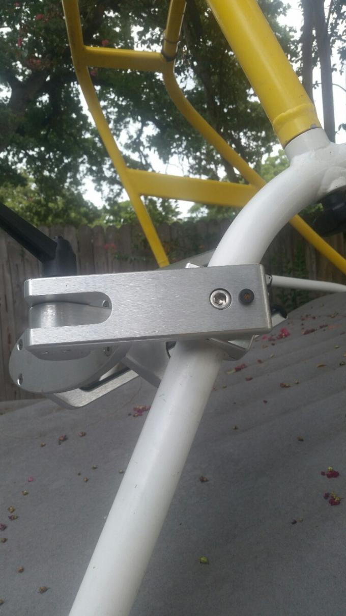

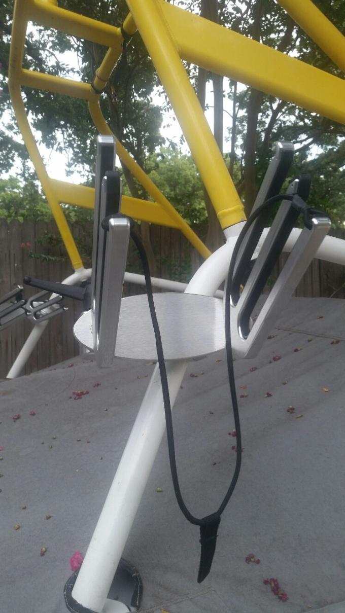

          I put the swing-in racks on my FCT2 this year. It's nice to swing them in when trailering or docking, but I never do it to get boards on or off. I put them on the bottom section of the tower; the mount has a swivel that makes up for the slope of the tower.

            Ken,
            You have any pictures of your setup?
ID:	495185 Click image for larger version
              I'm not sure of brand, picked them up from ebay for $90/pr new from an individual that could not use them. You can sort of see on the first pic where it is swung in the boat how the part that mounts to the pipe is at a different angle than the forks. The large allen bolt can be loosened to adjust the mount angle vs. the tower angle so that it holds the boards level.
