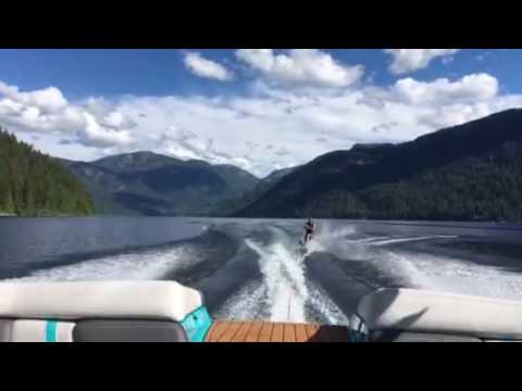

I totally forgot about that! Yes, its a toughy to ski behind. Problem is not only the size of the bump but the depth of the trough between the bumps. Prop wash is also quite hard so its like you have 3 major bumps to get across. This is the second video afer his first attempt where he had 1 turn. He had already backed off a lot going across the wake at this point. In his defense, this was also his first time on this ski, it was not his own. FWIW this is at 30mph, no ballast, 2 adults and 3 kids in the boat, ncrs at 0:

A little off topic but man what a great looking riding spot in that video! Looks like a really fun place to ride for sure!2009 Super Air Nautique 210 TE

Yes it is , we live across the lake from each other. Very little wind, it is busy on weekends during the summer other than that it is a great place to ride. If you are into mountian biking there also lots of great trails in the area too.
