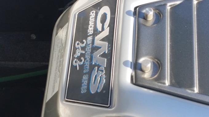

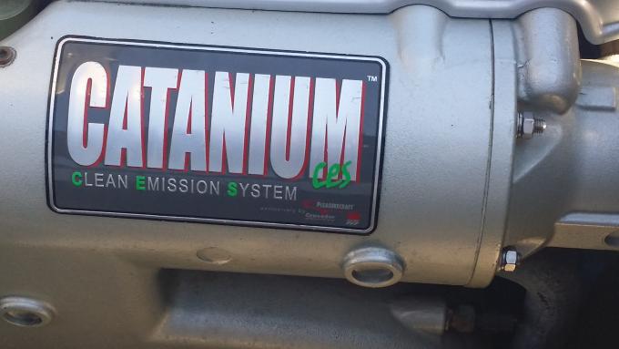

ID:	494017 Ok New to us boat, I want to change out the water pump impeller but it's not like my old mastercraft.
    Boat decals say pcm. Engine says crusader? It's a 2011 super air nautique 210 Coastal Edition.

    Chevy 5.7 liter. Crusader is simply the coastal edition made by PCM.

      I'm trying to find what impeller it has ? I ran the motor for a few min and left the intake valve closed.
      It's still circulating water but don't want to take a chance
      I want to replace it .

        It's the 343 which is the same as the Excalibur, be sure and buy a genuine PCM impeller, have heard the Sierra is not of the same quality. White lake or Ski-Dim will have what you need, buy 2 so you have a spare, if the old one is not torn up keep it also as a spare spare.
