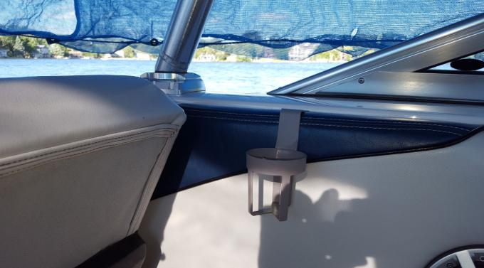

            here is how you add Cupholders to Gunwales....get over yourself...lol
              [ATTACH=CONFIG]n493443[/ATTACH]
