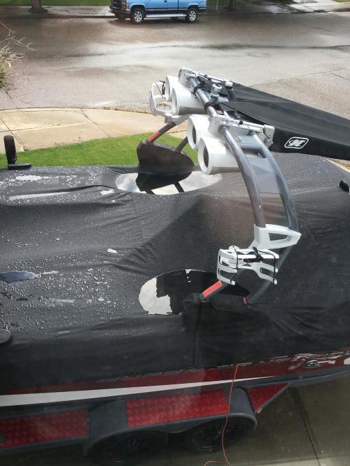

Anyone figure out a way to stop this yet? Thinking of rigging up some sort of T-bar out of pvc.

I do. You can see its that raised point between the tower legs. It's set up exactly as it comes from Nautique and it still always seems like I get these two pools just inside the tower legs.Originally posted by lucky7t View PostDon't you have a pole ? Our 210 has a pole and we use it under the cover to lift it

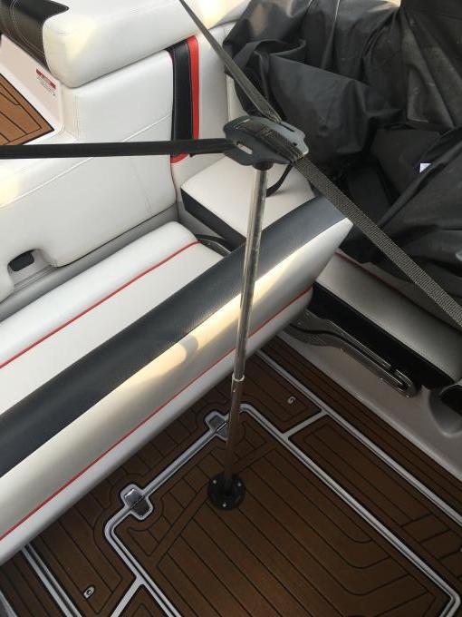

Be certain that the rear pole is extended all the way. I believe there are three settings, if I remember correctly. Also, make sure the rear pole straps are tight. Are the three rear cover tie-downs connected and tight (rear lifting rings and center handle)?Please do not PM me directly asking for advice on how to repair your boat. While I would love to help everyone, I simply do not have time to respond to all of the inquiries. Please post your questions on the forum, so that all of our members have a chance to answer.
I'll grab some pictures of the strap/pole set up next time I take the boat out, pretty sure they're installed correctly though. This dam rain is stopping me right now.
I am parked bow down though since my drive way is slanted.
No, that doesn't explain it.

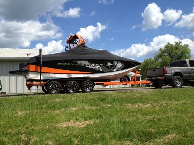

Bevostein's cover was only used in 2013. The newer covers mount as shown in the first picture in this thread.
That's not the issue here.
The more I look at your picture, the more I am convinced that your rear pole isn't fully extended.

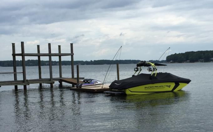

Here's the cover on my boat, and as you can see, the cover mounts lower after 2013.
