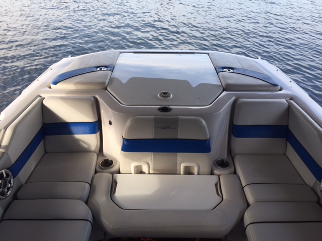

      my original plan was to do only a part of the back pad as well. Once I got into it I realized t would have been MUCH more difficult so I switched gears and did the entire pad

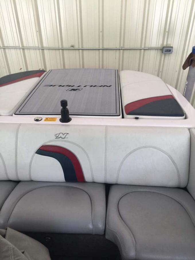

          here is one i saw posted to a nautique group on facebook over the weekend, on a classic 210. it looks great too i think ... not sure if the guy is on the planet, so my apologies for borrowing his picture. it was so pertinent to this thread, so i wanted everyone to see it.

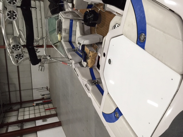

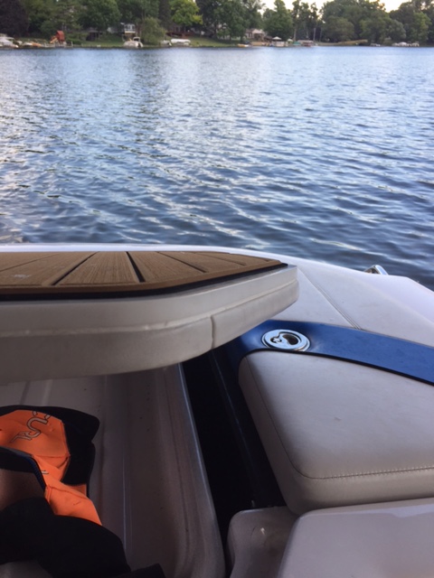

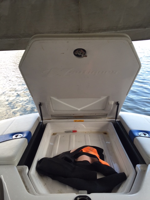

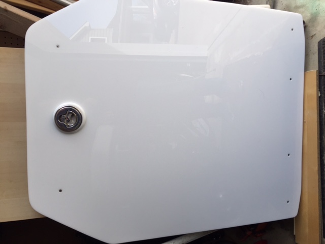

ID:	493353 The problem is that the fiberglass part of the pad is unfinished under the foam and vinyl... It also has that silly door access to the storage tray. Its all uneven and different materials. The foam pad under the vinyl hides all that. I was going to glass and gelcoat etc but decided the acrylic is a better way to go. Its one large piece of acrylic cut down to exact size of the existing shape that is glued and screwed to the existing fiberglass. The hatch is also not flat so we needed to heat it and unfortunately needed to run screws thru it. I knew I was going with the seadek so I just put the screws in a spot that I knew would be covered. Here is a picture of the hatch and the installed hatch before the seadek came in. The acrylic is a different white than the gelcoat but it isn't too bad once the seadek coved 95% of it. Wasn't worth the extra $$ color match and paint

                  here is a few more pics of the underneath and the tie in of the acrylic to the existing fiberglass Click image for larger version
