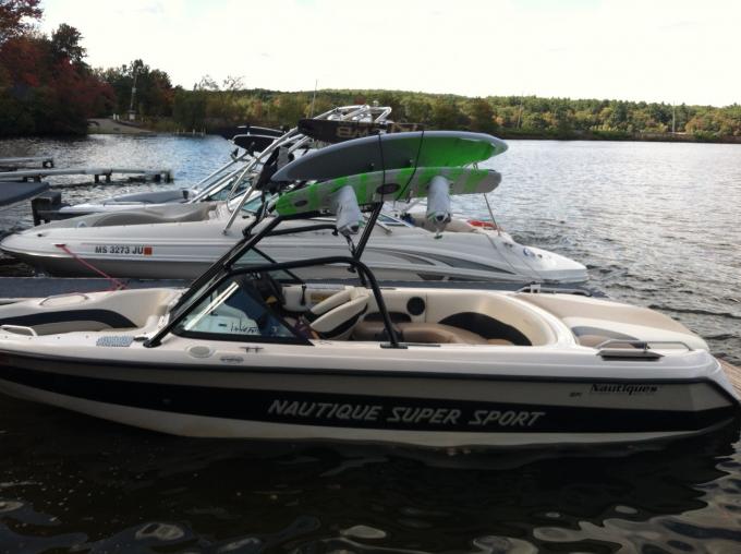

      Gen 1 FCT 1:
      FCT2/NDT, notice thicker diameter and it hinges forward halfway instead of from the feet:
