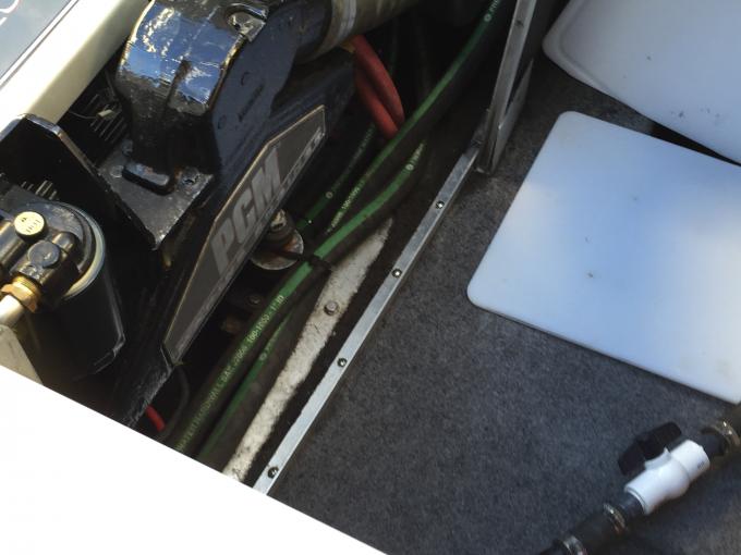

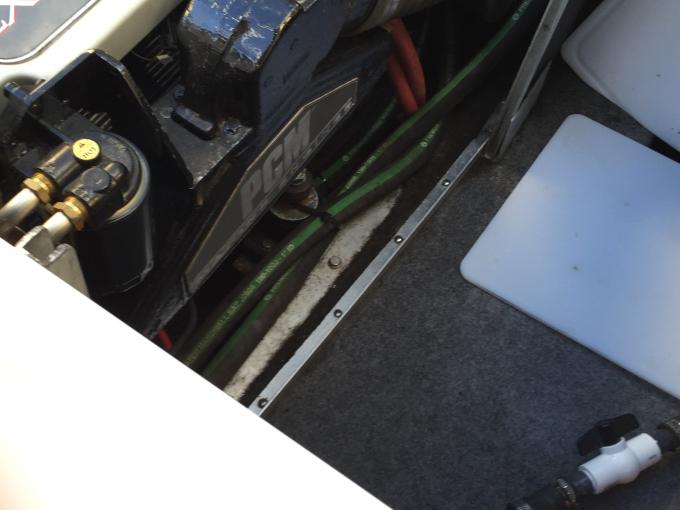

    Not sure on the 14 but my dividers will go in backwards. The hatches just won't lock shut. Just run them for a day in reverse if you can. That will flex them back straight

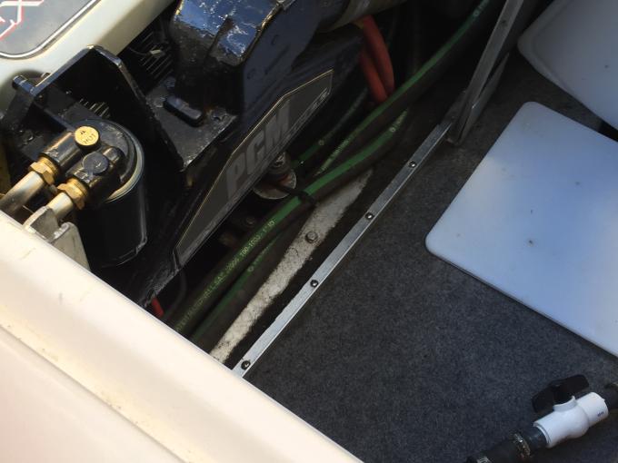

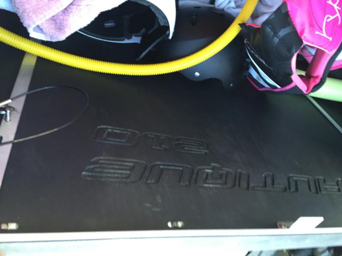

    I added L channel to my floor. I'll snap some pics of the l channel and pin placement in a bit.
    • swatguy
      • 1669
      • Midwest/ Northern IL
      • 2008 SANTE 210
      Here you go
      Excuse the pile of gear just got back from a trip.
      • Austin179
        • May 2014
        • 115
        • League city
        • 2019 G21, 2014 SAN 210, 2000 Sport Nautique
        Thanks for the pictures.
        Our setups look a little different.
        I'll post some before and after pics once I get the repairs complete.
        It looks like you moved the pins from the top to mid way down. Is that correct? Or did you add additional pins?
        • swatguy
          • 1669
          • 2008 SANTE 210
          I moved them. She they came from the factory pre drilled there seem to be enough flex to bypass the original holes. They were so close to the edge it didn't seat properly.

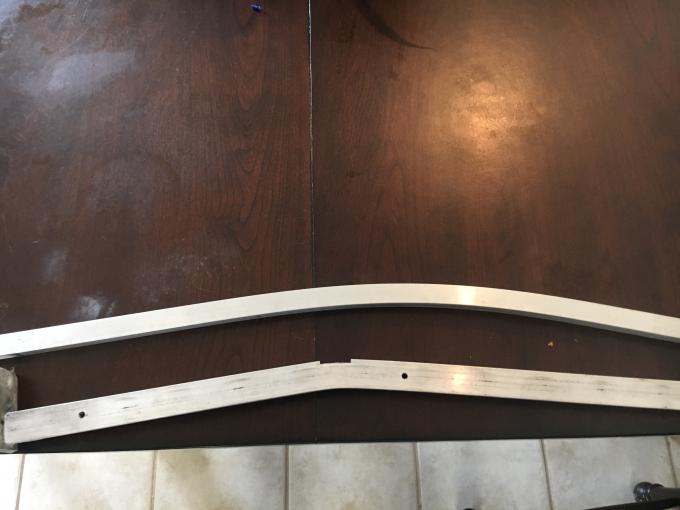

ID:	492988 So here are a few pics. These things are pretty bad. Bending them back doesn't seem like an option. Not sure if they can be purchased or not from nautiqu so at this point I'm not sure what to do. Click image for larger version

                new brackets from nautique and the wake makers divider support kit should be in tomorrow. I really hope that support kit works and this doesn't happen again. I'm also adding a QR pin thru the bottom c channel and divider on each side to keep it from popping out. I'll report back after everything is done and I have some time on the water to see how it holds up.

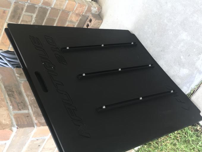

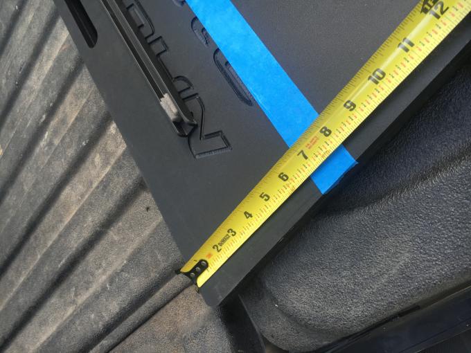

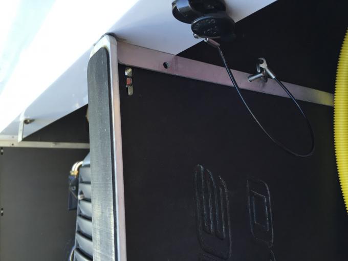

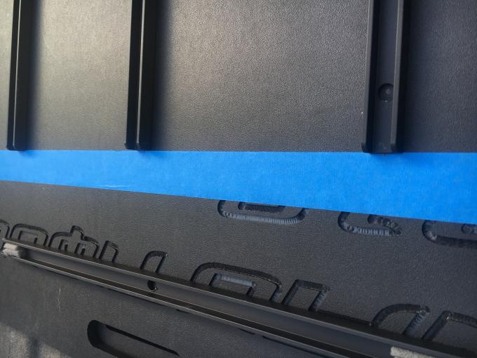

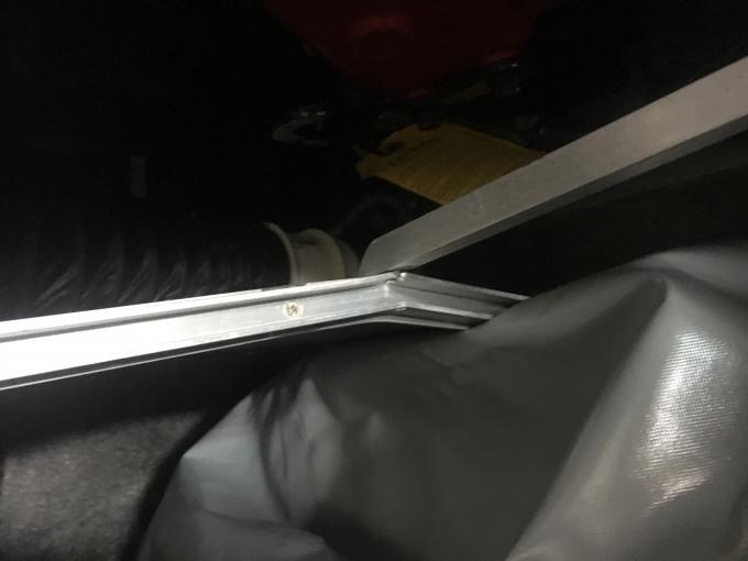

                    Got the brackets from nautique and replaced them and also got the wake makers kit installed.
                    I did notice a couple it things during the Proccess that I need to fix.
                    1st is that the dividers do not slide all the way into the bottom channel.
                    They need to be shaved down on each side at the top.
                    This will help keep the divider in place. This was not due to the new brackets (they were exactly the same), but just something that I noticed.
                    Also the screws on the wake makers kit are a little long for my liking.
                    Here are a few pics. Overall pretty easy stuff.
