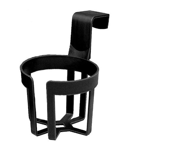

                Cup holders...so true...got me a couple of these...work great!

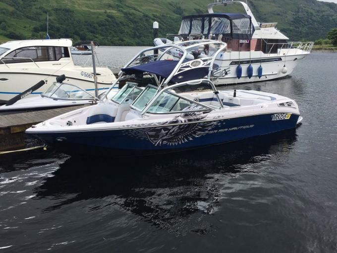

                    Managed a quick test in the 220. Overall I was very impressed. With ballast full plus 500lbs of lead in the centre locker the wake had a lovely kick to it. 22.5mph was the slowest we could go (interestingly with no ballast the wake didn't clean up much earlier) but conditions were not ideal. As others have said the side to side weighting needs to be perfect as it only need be a little off to wash the wake out considerably. I can guess that other factors such as side wind, placement of boards in the racks etc will affect the lean of the boat and consequently affect the wake meaning having to play with the balance a bit. That said, a few bags of lead will take care of that, so I don't see any issue.
                    A few things didn't work or require repair -the steering was stiff so requires a new cable, the Perfect Pass display was dimming then going out (usually a sign of moisture) so needs replacing, the tacho, blower and one amp didn't work. Other than that a few little areas to tidy up, but nothing that would cause concern.
                    The seating is a bit strange, when you open the engine lid, there is loads of space so really no need for the "hump" at all. By my reckoning (and excluding the bow) the boat will seat 7 including driver comfortably, with the centre seat, you can bring this up to 9 but may feel a little cramped.
                    All going well I'll have a 220 in the near future..... Click image for larger version
