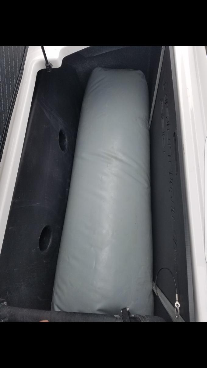

        I have a 230 but the "pro-ballast" is basically the same. One port bag and one starboard bag, NO additional belly weight. each bag is about 400lbs...but most people will upgrade these to larger bags. However, with larger bags it is likely you will lose room for your storage trays. There are a few threads on this site about upgrading so do some reading and see what you think. Below is a picture of the stock pro ballast bags.

          That sac looks tiny in there. I put the standard 750's in ours but have honestly realized ours does not like all that weight. We end up with stock plus surf side 750 full as well as a 370 lb tube sac in the ski locker. I will fill the non-surf side 750 and empty until the wave cleans up but it's usually only about 1/4 full.
