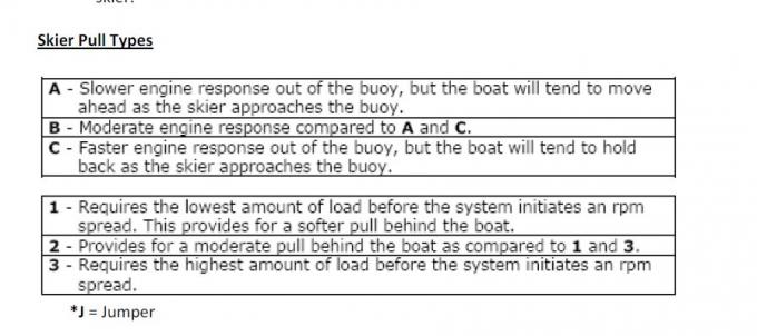

Well I recently opted for the R2 Attena Upgrade to try and solve the surging issue I was having when boarding. The upgrade is nice and is just a touch smoother. its 10 fold better for surfing. However I am still not necessarily happy with its overall performance. Spoke with guys at Zero Off for some clarifications and setting recommendations, but all the info they were giving me is slalom related. The really had no insight on wakeboard settings. All their pull characteristics are bouy and ski related.
Here is my dilemma. I ride multiple times a day from fully loaded with around 1800 over stock, stock for the wife, to almost empty for the kids.......... and somewhere in between for guests. The boat is holding speed fully loaded ok. However at the stock ballast point or anything under it fluctuates anywhere form .5-.7 mph and seems to "hunt just a bit.
All my Perfect Pass units had finer adjustments like KDW, NN, CN etc to dial it in and I was right on with maybe a .2mph fluctuation. Anyone have any tips or clues how to get this dialed in? Currently using the factory default slalom 58 settings. the only finer adjustment Zero Off gave me was the A-B-C !-5 or so pull characteristics to play with. Or is .5-.7 the acceptable range for the Zero Off? just seems no where near the smoothness of the pp units I have had in the past
