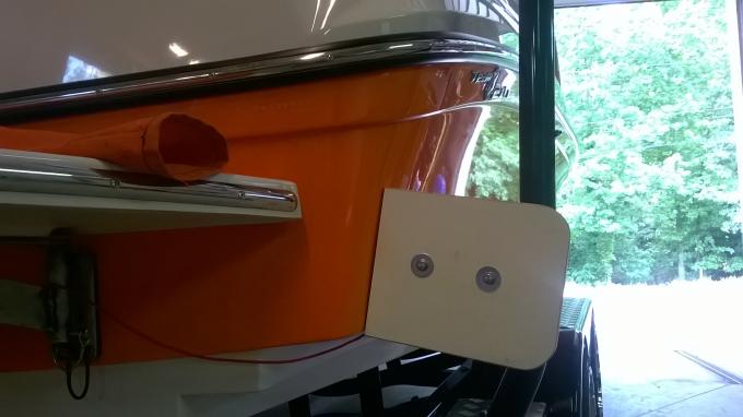

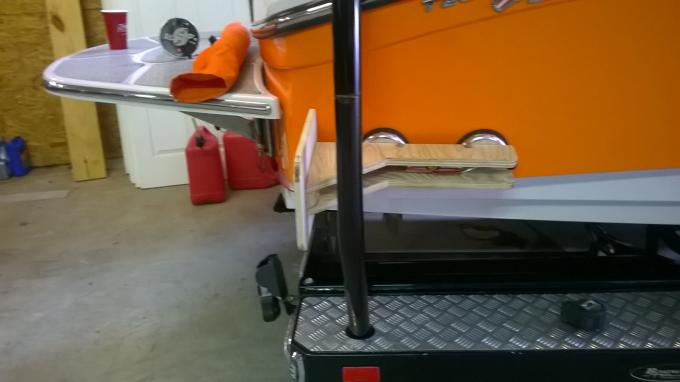

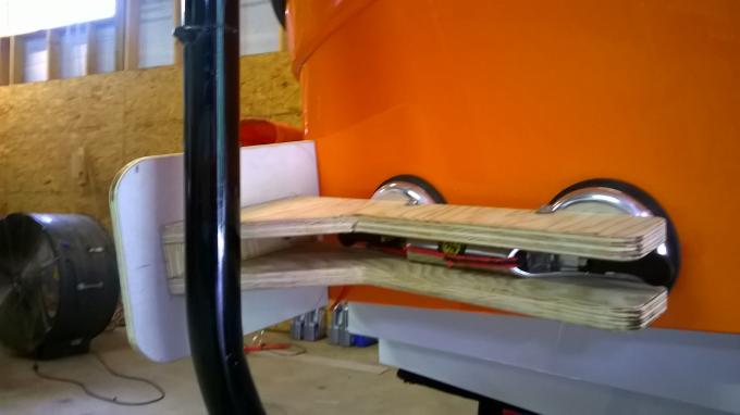

ID:	488939 Just curious how people with 2nd gen 210s are getting a good surf wave. I have stock ballast with 600# pound sacks in the rear and an under seat sack in the bow. I've also made one of these Ghetto gates(see attached pics), but I can't seem to get a good wave going. I can get a tall wave but it's really short and close to the boat and it washes over at the top really bad. Any helpful tips would b great.

      Try running your ghetto gate the reverse of what you have now. ie the plate at the stern.

        I made the same style surf gate tested it today works great try flipping it and moving it back to about 1/2'' from the transom lower it to the first step on the hull.
            I'm not sure my gate will fit on the one of the steps on the hull. I would definitely have to reduce the width of the gate. I will try turning it round with the gate to the rear of the boat first. I couldn't move it back much further than what you see in the pics because I couldn't get the rear suction cup to grab because of the slight curve of the hull.

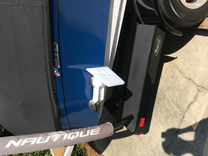

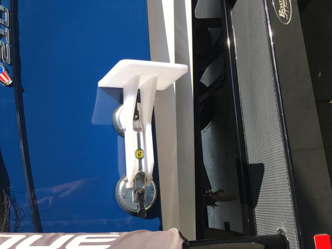

ID:	489164 Put it just above the top step and about 1/2'' from the transum.

                [ATTACH=CONFIG]n489164[/ATTACH] Put it just above the top step and about 1/2'' from the transum.
                [ATTACH=CONFIG]n489162[/ATTACH] [ATTACH=CONFIG]n489163[/ATTACH]
                I will see if I can get my gate to attach that far back before I try changing the angle of my gate like nr2041 suggested.

                  This was just a prototype I through together. I made it with 2- 1/4-20 bolts holding the gate to the frame [last pic]. I will make some different shape gates and let you know what works best. I was going to make the finished product out of starboard. I have since found out the wood one floats so I will just stay with wood .
