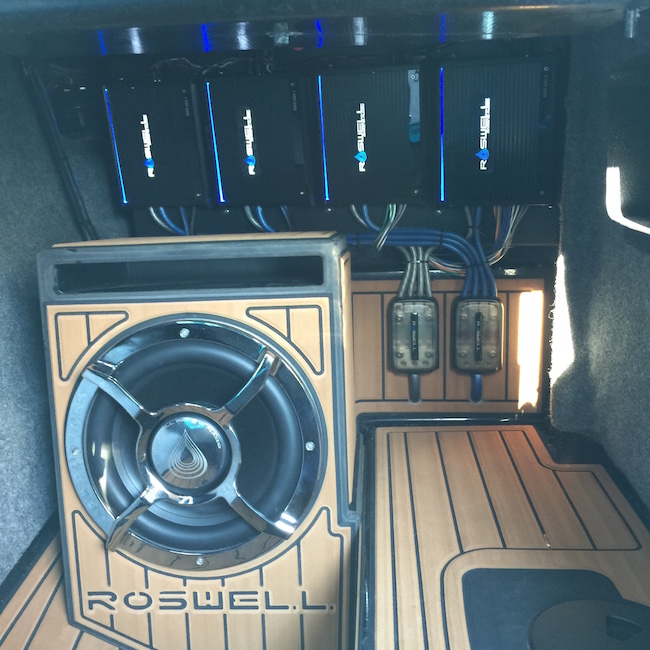

I am mounting some distribution blocks as shown in this picture below. I noticed that the screws that I used barely protrude through the other side. But the wall is not all that thick and I think if I use any shorter screws, they may not bite and hold the distribution blocks in place. I don't think the bag goes up that high, but am unsure if this is an issue. My options are to remove the subwoofer next time I am at the lake and check, or just remove the subwoofer to through bolt instead of screw them on. I've already removed the subwoofer once to run the wires, and the screws are already starting to strip on the sub, so I would like to not have to remove it if anyone has an idea how full the bag gets up there.
The bag does not come up that far. You will be fine with them mounted there

you can (and should) back the screw out and cut off the tip that is protruding through the wall... since the hole has already been made it will thread back in without a tip.
use a dremel or some tin snips depending on the hardware you are using.
