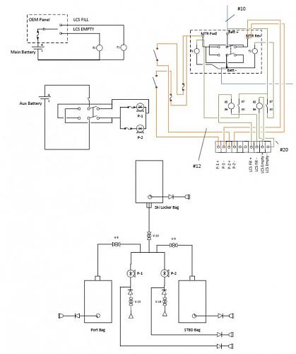

Here's the dash wiring for a 2000 SAN:
200 SAN Dash Wiring
Here's a schematic of the plumbing. This is from a slightly later model, but the layout should be similar.
