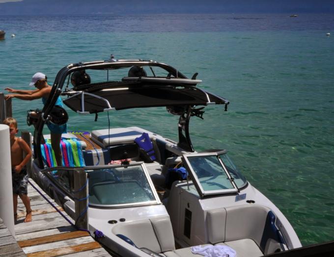

    Older Picture on Tahoe that shows a board being stored you can store up 4 boards with the setup.
