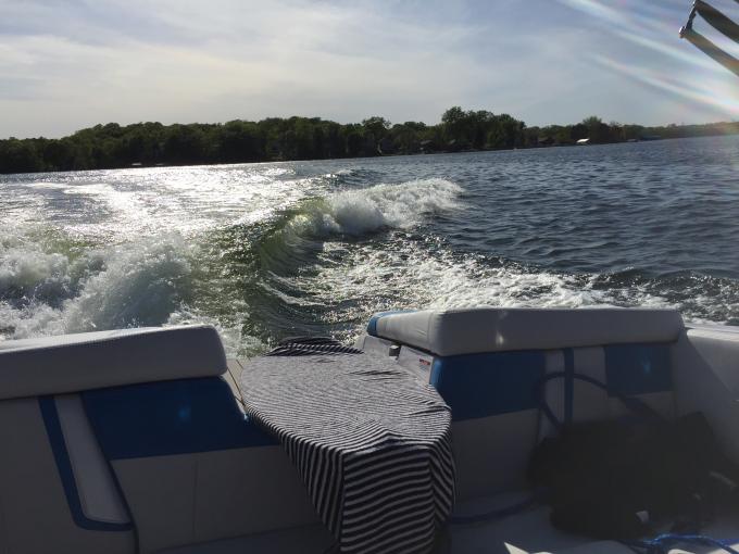

        Still playing w exact placement but put 350 lb of lead in the port corner and 200 lbs in the bow lockers. Port wave went from good to great imo. Picture below w 2 people in the boat.

          That does look a little longer, smaller but longer. How about moving that lead from port corner to port bench? We put a 400 sac in the port locker yesterday and tried moving people up front to see. But the wave didn't get much longer, it was definitely better with the sac in the port bench, but we have seen longer waves out there so still trying to dial it in.
