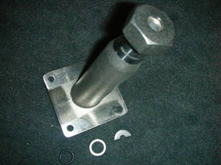

            So - I think this is/was my problem. In Engine compartment I was able to back off the "nut" that holds the cable to the thru hull - however, two half-washers (metal) fell out and I can't figure out how they go back in? They are the half washers pictured here (image from Nautiqueparts.com): Click image for larger version
            There was definately some corrosion in there - got it cleaned out and can now freely move cable/shifter. Just need to figure out how the half washers go in? The o ring and full washer are around the cable (behind the large nut pictured). The half washers go in there too, just not sure if before (closer to back of boat) or after (closer to front of boat) the o ring and flat washer? Anyone?

              I wish I had been paying more attention to the mechanic that was doing it, but I am not sure. did they fall out immediately after removing the nut? I would assume they are a split washer just meant to spread the force of the load from tightening down on the nut to the o-ring and keep the o-ring from being pushed back out via water pressure.

                Yeah - just fell out. Think I figured it out. O-ring nearest to transom, then flat washer, then split washer (two halves). There is a groove that the split washers fit into nice and snug. Hope it's right! Helped to remove engine divider on Port side to get to it, btw.
