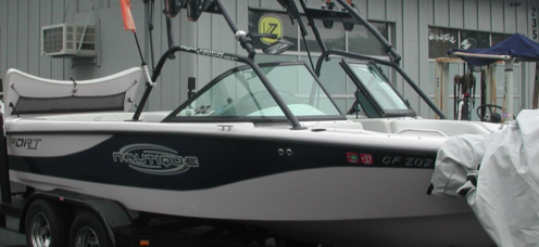

      Sorry, here is a screen shot of the boat I am considering. Yes, the hour guage has been replaced but, everything else looks original. Are there quality gauges people are replacing them with? I have read a few posts about electrical issues back in 2000-2002.

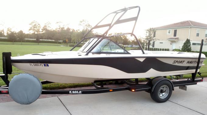

                          I have owned a 2000 Sport Nautique with GT-40 for the past three years. It has been a great boat, no issues at all so far other than water in the fuel which I blame on ethanol. Otherwise, it has run just fine. Great family boat and good for wake boarding, slalom, barefoot, whatever watersport you like. I am a barefooter and the top speed of 43 mph is a bit slow for some things -- 46 or 47 would be better. I would buy it again. My previous boat was an 89 Mastercraft Pro Star, which I liked very much too. This one is better for the family though.
