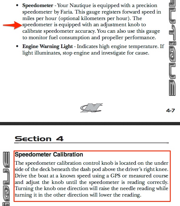

I have a 2009 SAN 210 with less than 200 hours. My speedometer seems to be reading too high. Is there a way to calibrate the speedometer so that it will read correctly?
Tags: None
It can, yes. Here's a link to the manual website. Select from the list: IS0151 "Serial bus Gauges - CorrectCraft - PleasureCraft GM engines
http://faria-instruments.com/manuals.php'08 196LE (previous)
'07 196LE (previous)
2 - '06 196SE's (previous)
Typically these gauges are not dead on accurate throughout the speed range so ideally you should calibrate at the speed you use most, if 23mph wakeboard, dial it in at that speed so you know you are accurate there.
FYI, SE boats have the adjustment knob under the dash, but LE's and TE's you need to adjust on the speedo itself. At least that's how all my boats have operated.'08 196LE (previous)
