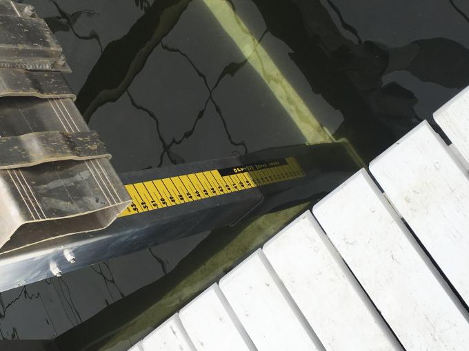

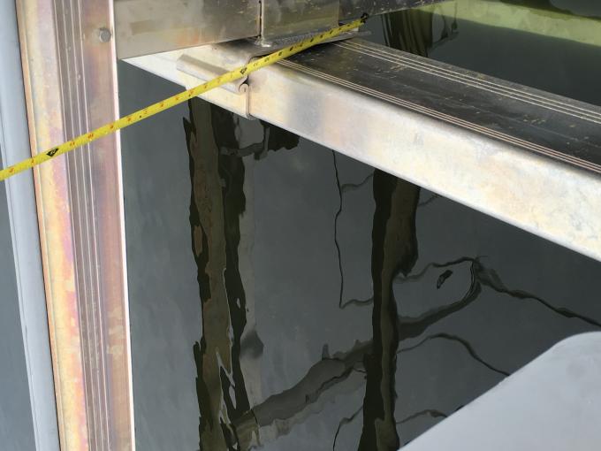

                Ok. I some info for you. Mine is in 40 inches of water. I used a tape measure and it agrees with the measurements on the Floe scale (pictured). Also the Floe dealership installers returned today so I asked them what the minimum depth is to use one. The said its 2 feet. Its determined by the width of the beam in addition to the thickness of the pad that the boat sits on. So in other words, from the bottom of the cross beam to the top of the pad (24 inches).

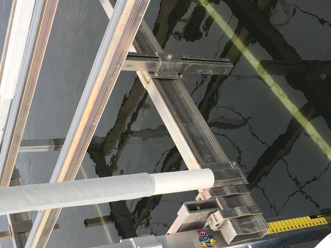

                          Thinking about switching to Floe, again this year. It looks like the bottom cross beam is awfully close to the bunks. Do any of you who have a Floe lift, ever have an incident with your prop hitting the rear cross beam?

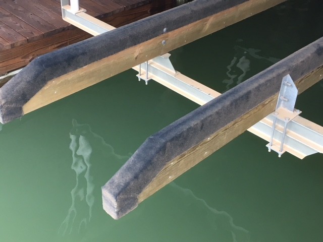

                            If you decide not to go with a Floe lift you may want to go this route with a double stack cross beam to prevent the prop from hitting the cross beam. I store a 2017 G23 on this lift. which I redesigned the cradle when I purchased the boat

                              We have had a Floe with the G23 for a few years now and have never had the prop hit crossbar. I usually kill the engine right before halfway in and grab lift to guide boat to lineup gas cap with rear lift post. I worried a lot about prop hitting at first, so that is how our routine was established. We have double guide post on the rear and single on the front. I would highly recommend a double on front also with a G. (will be a future add on for us).
