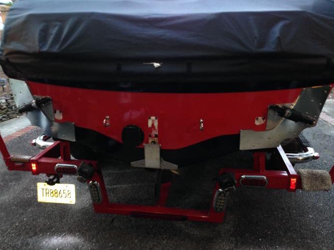

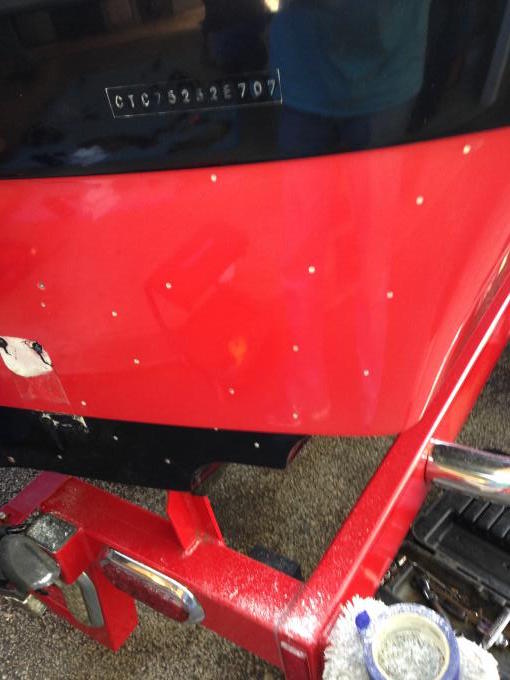

    I just recently installed NSS on my 2007 236. I have the install instructions for the 230, and with a little imagination, you should be able to use them for the 210. Send me your email address and I will send them to you. There is a template that you use to drill the first few holes, but I did not have that. I used a couple extra hands to get the plates positioned correctly and measured 1/4" from the edges. Overall, it wasn't that bad of an install. I had to move my platform brackets higher on the transom, and that was probably more difficult than the NSS install. I believe there were 58 holes in total drilled through the transom, so get ready for that! Feel free to ask any questions, more than happy to help.
