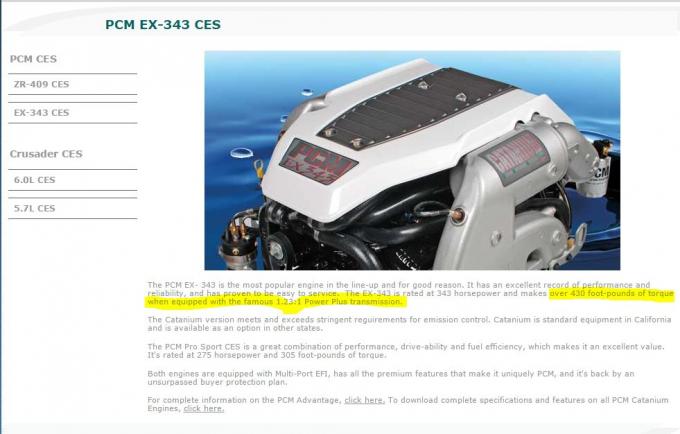

      Here is the pic. But what I would like to see is the comparable math. What is the ? number? (Don't back into it, provide number and backup from pcm)
      ex343 = 430/1.23 = 350 crank ft lbs
      H5 = ? / 2.0 = 405 crank ft lbs
        The ? Would equal 810lbft at the prop shaft. It is 405 x 2.0.....
        The 343 numbers are derived from the 350lbft of crankshaft torque multiplied by the gear reduction of 1.23:1, which equals 430lbft of propshaft torque.
        Neither figure set accounts for parasitic drivetrain losses, which would reduce both prop torque numbers slightly. Not really any need to have PCM back up the propshaft torque number if they give the engine torque, and the gear ratio. There is no need for backup. It is a mathematical certainty.....

          Wayward, Do you really believe the ex343 puts out "350 crank ft" lbs as compared to the h5 which YOU are stating is putting out 810?
          I doubt if there would be that much variance between the 2 engines.

            No....... You asked somebody to solve for the "?", which is the PROPSHAFT torque in the equation. The "crank torque" is stated as 405lbft (which, yes, I believe it is likely that the H5 might actually produce 405lbft)
            Now...... If it does, in fact, produce 405lbft, as advertised, and is then routed through a 2:1 gearbox.......... The propshaft torque will be 810lbft (minus a small amount for parasitic losses through the gearbox.
            I don't have to believe anything. If the facts you gave are true, then my calculations are correct. I solved for "?", which was what you asked for.

              I think he was asking for the manufacturer to provide the ? # and not ask us to back into it. Because backing into it would provide an unbelievable output number which is proven by the 810 lbft you got when you solved for the ?.

                I guess I am at a loss here......... So, let me ask this- Is everyone in agreement that PCM advertises the H5 as having 405lbft of torque at the crank?? (Visiting their website confirms this)
                It does not matter if PCM advertises the propshaft torque or not. There is but ONE SINGLE WAY to calculate output/prop shaft torque. If they advertised it as anything but 810lbft with a 2:1 transmission, they would look very stupid........
                I didn't "back in to it".
                810lbft is not at all unbelievable
                There is only one answer to the question, no matter if I say so, or PCM does.
                If you want to calculate output shaft torque, the only way to do so, is to take your input shaft torque and multiply by your gear ratio. That simple calculation gives you your output shaft torque.
                For instance, if you swap around the engine or trans, this is what happens.....
                H5 with 1.23:1 transmission would have 498lbft of propshaft torque.
                Ex343 with a 2:1 transmission would have 700lbft of propshaft torque.
