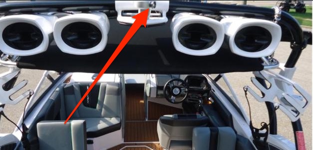

This was actually a factory option in 2013.Originally posted by JoeA View PostAnybody ever installed a rear camera on the G23 and integrated in to Linc screen? How did you do it and what would you do different next time?
