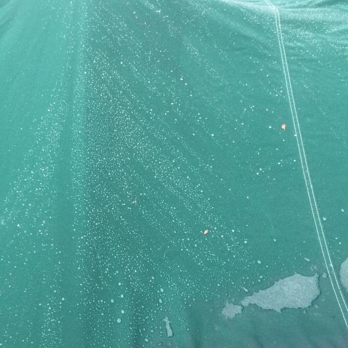

This reminded me about 303 Fabric Guard, and how it can restore the water-repelling qualities of our covers. I happened to have about 1/3 of a gallon left over from years ago, so I took it down and put it on my old cover yesterday afternoon. This was a quick and dirty application because rain was in the forecast for later in the day and all day today.
I went back down to the dock this morning to see if it did any good, and I am very happy with the results! I had planned on getting rid of this cover and getting a new one, but now I think I will just buy some proper support poles, adjust the snaps in the cover for a tighter fit, fix the few small holes and keep this one!
