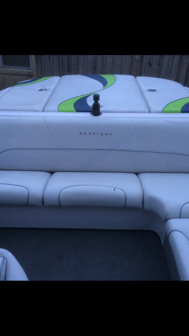

              I have a 2006 and the ski pylon is right behind the rear seat.
              Does yours not have this?
              1989 Sport Nautique

                  Scott...that's what I was picturing also. Maybe something to do with Australia or someone took it off??

                    Hey scott
                    That is exactly what I was after, no my boat does not have anything like that at all
