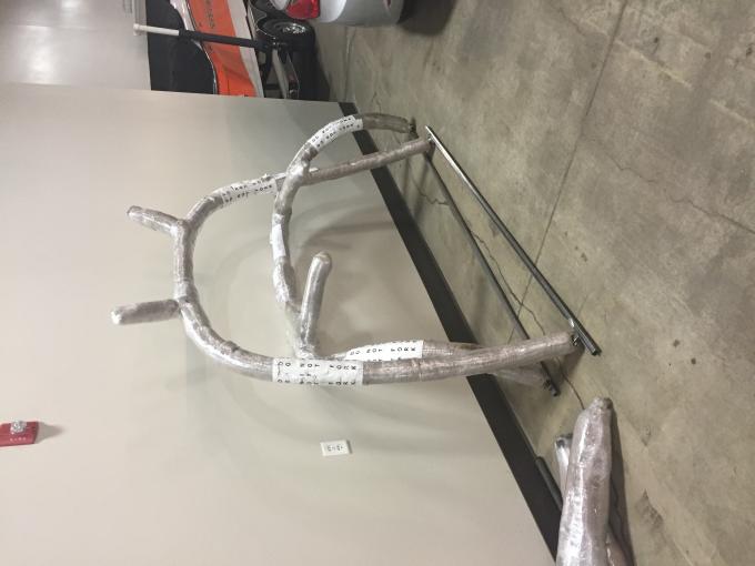

              I couldn't figure out how in the heck it happened until I saw the other pictures. So you were pulling in forward and hit the tower, right?
              To answer your question, I would get a shop to fix it, but it takes a skilled shop, not just some guy with a hacksaw and welder. You could have them cut out the middle section, and weld in a new segment. The welds could be hidden under the speaker clamps.

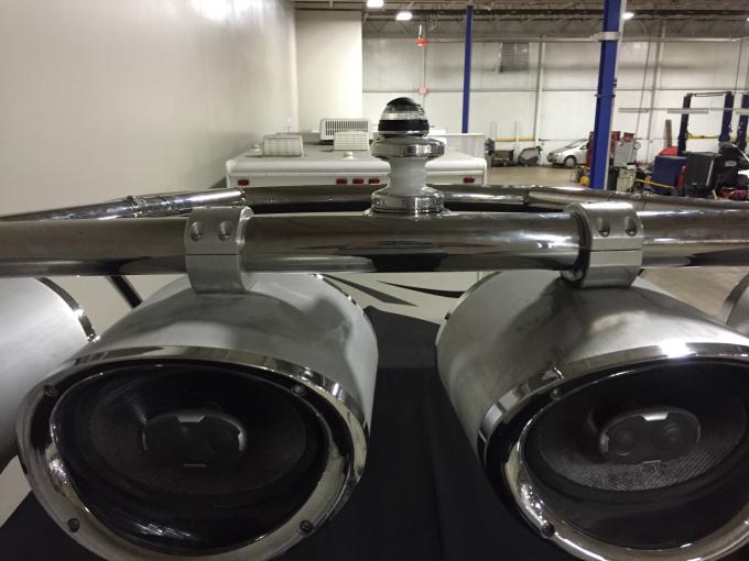

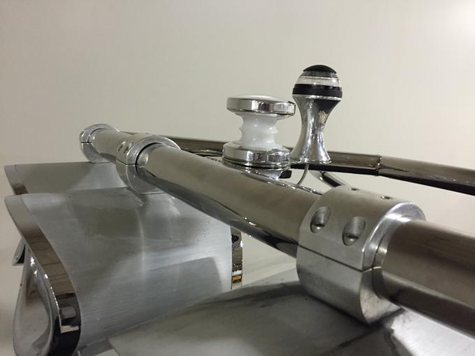

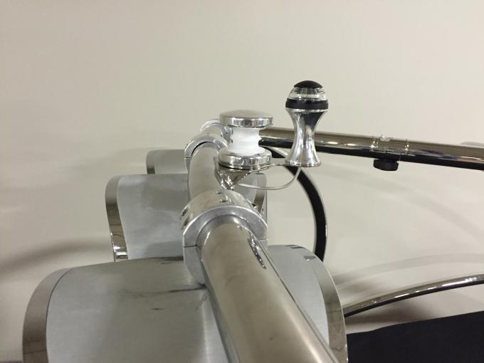

                    Repairs are complete. In the end I decided to send it to Star one. I'm sure it would have been cheaper to find a local shop, but Scott did an amazing job. They rewired the tower, replaced the cracked spool and polished the whole thing. It looks new.
                    Welds were placed under the speaker mounts, but you really have to look to see them. the coupler fits perfectly.
