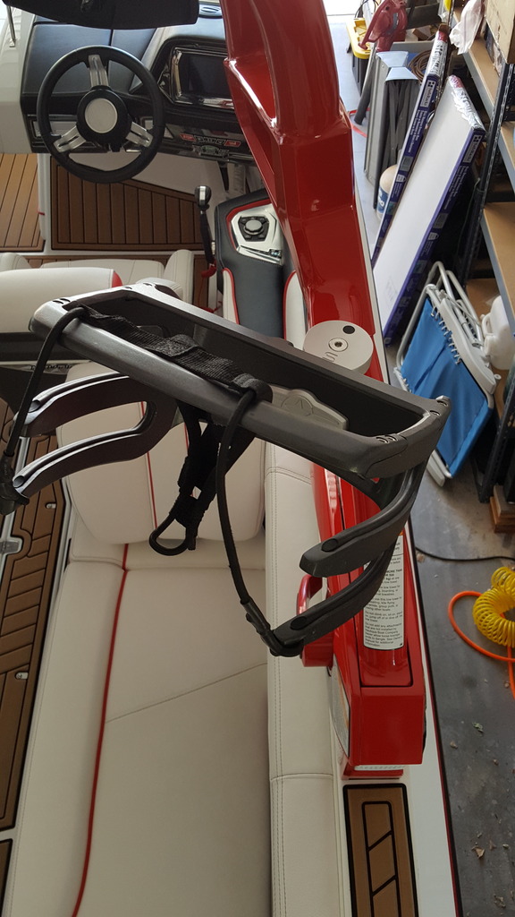

            Originally posted by Armour783 View Post
            That's just it. My 2016 G23 board racks DO rotate a full 180° causing the board in the top slot to impact the speaker.
            No they don't rotate 180 degrees. They rotate quite a bit less, about 120 degrees, and at about 90 degrees, a board will hit the speaker if it is still in the rack unless you invert the forks. Unless you have older racks, then they will go pretty close to a full 180 degrees. I have no idea why Nautique thought this was an upgrade. Like the other poster noted, if he leaves his boards in the racks and had no tower speakers to worry about, he still could not rotate them far enough to get through a narrow garage door opening.
            Here is mine pulled in as far as it will go. You can see how far a wakeboard will stick out to the side even when fully retracted.

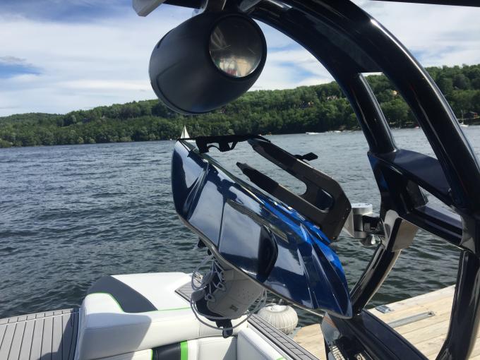

              #21
              No, you're wrong. My 2016 G racks swivel almost a full 180, past where yours are in the picture. I've attached a picture
              Here is the dealers exact email response when I questioned why the racks swivel a full 180 causing the boards to impact the speaker WELL before the locked inward position.
              "Board racks, unfortunately that's a design flaw. Nautique has never run speakers this large and found it to be an issue with the board racks. Remembering now, later through the 2016 model year, they changed the swivels to only come in 145 degrees instead of 180. holding the boards at an angel that now clears the bigger speaker. I'm sure Nautique will cover the time to replace the swivel inserts if you're interested?
              Let me know!"
              I said yes I wanted the inserts installed. They are being installed this week along with the 25 hr service.
              With my wakeboard in the bottom slot, boots down, I can rotate the racks almost a full 180 and have the board parallel with the boat, the tip not outside of the boat at all.
              Looks pretty close to 180° to me, what do you think:
Name:	Nautique G23 Board Rack.JPG

                #22
                Looks like Tallrider's boat has the inserts your dealer told you about
                  Don't get testy. I am not picking on you, just answering the other guy's question about having his boards rotate all the way into the boat so he could minimize the width of the boat. We are both right. My boat was finished in February, and I can only assume that yours was made before that. I even indicated in my post that you might have older racks, which is true. It is now clear they made a mid-year change.
                  Back to picking on Nautique, the fix does not stop the boards from hitting my wetsounds speakers. And looking at it, I don't think it would stop boards from hitting the factory speakers either.
                  I don't think I have any insert, assuming I understand where the insert is placed. I will try and get another pic tonight.

                    #24
                    Maybe by insert they just mean a new swivel block that only goes to 135°? I don't know.
                    I think all of this could be avoided if they just went the way mastercraft has their racks, with stops at 0, 90, and 180.
                    All the way out for riding down the lake, all the way in for storing in the garage and towing, and 90° for grabbing boards out while out on the lake without impacting the speakers.
                    I don't see how Nautique didn't see this design flaw.
