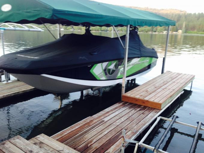

            I have a sunstream 6500lbs lift. Unless you have to have the larger lifting arms it lifts my G23 just fine. I can actually lift it up with about half ballast and a full tank of gas. But it works for it.

                You also need to take into consideration the depth the water the lift will be in...I have the Sunstream 6500b lift, and am in 11 feet of water so needed leg extensions which i was told lowers the actual capacity. The dealer where I am told me he wouldn't put a G series boat on anything less than #8000.....he sells/installs 50+ lifts a year in the Okanagan area near Kelowna BC. Extremely happy with my lift vs all the Basta lifts on my dock.
