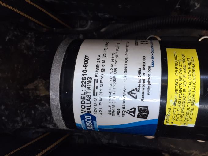

            Is the factory preset still at 10.9MPH? I found 11.5 to be substantially better. The new hull shape is not supposed to affect the surf wave.
            If you have a chance to take a picture of the ballast pumps, I would appreciate it much. They are supposed to somehow be new and improved, but I want to know how or why.
            My stock wave is very respectable. I am all about adding extra ballast, and frankly, I have not felt the need to do so.
            I will take pics of the pumps next time out, probably in a few days. The factory setting is 11.2mph. The new pumps sound much different. The previous pumps will start spinning at rated speed. The new pumps sound like a small turbine starting up, they start slow and the speed ramps up.

                            bsb4fsu , what size are the fittings and hoses for the ballast pumps? How much faster do you estimate the fill is compared to last boat?

                              Thanks very much for the picture!!
                              Same old 11GPM. Different pump numbers. Interesting. I don't find anything with a google search for that pump number. Often, they will just rebadge the same old 18220-1127 pump for different manufacturers. That way they can up the price and the dealer can offer a secondary markup as well. At least I know they did that with MC a few years ago.
                              http://www.defender.com/product.jsp?...4232&id=839452 Same 11 GPM here.
                              Increasing the outlet size is not really going to make a lot of difference if that is what they have done here. The current outlet size is more than enough to handle 11 GPM.
