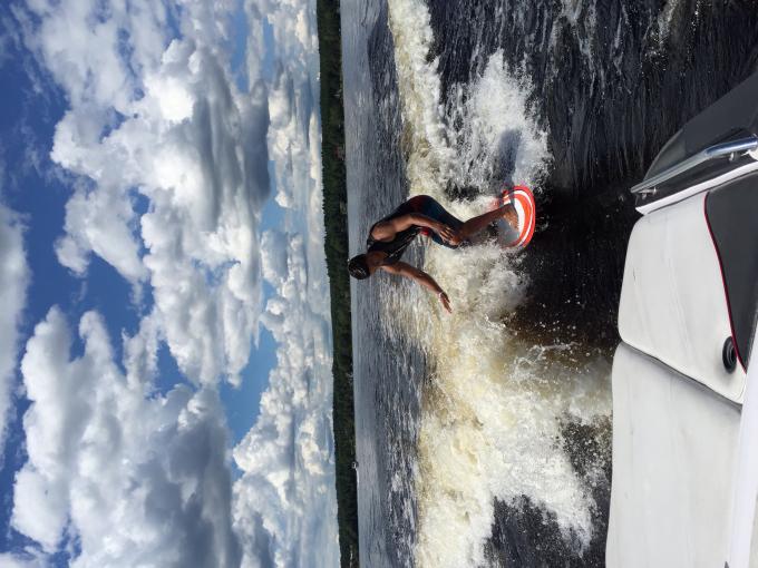

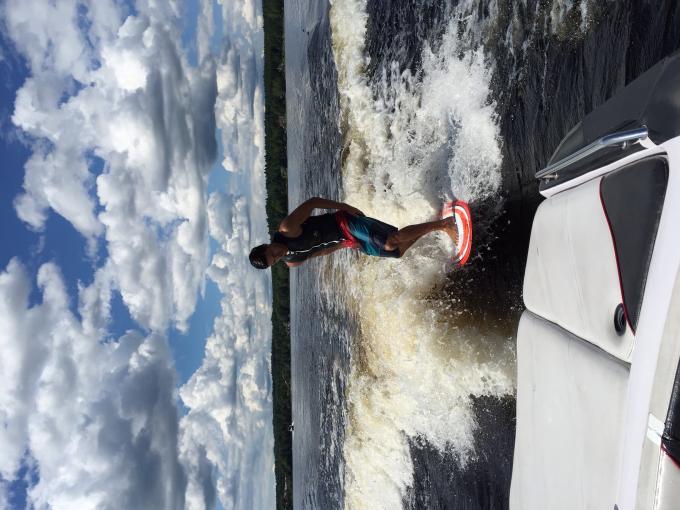

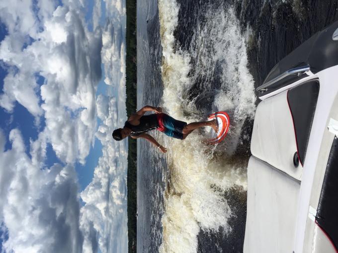

        Can you guys upload pictures of your wake ? To give me an idea of the shape your talking about.
        Thanks
