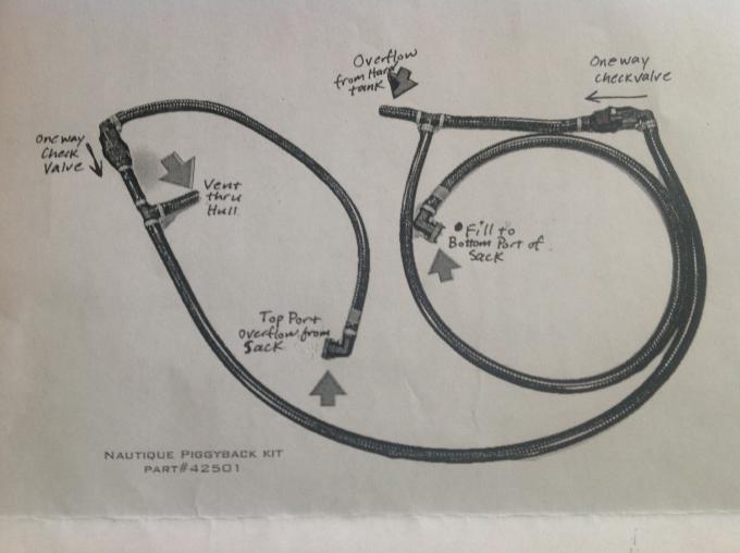

                    I have attached the diagrams that WakeMakers sent me regarding the makeup of the kit.

                      Here is a pic that I got from Wakemakers with the fittings labeled.
