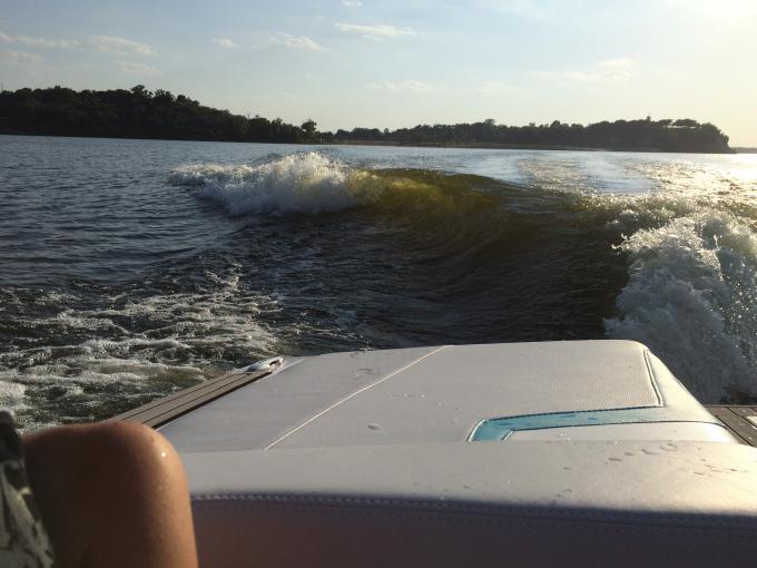

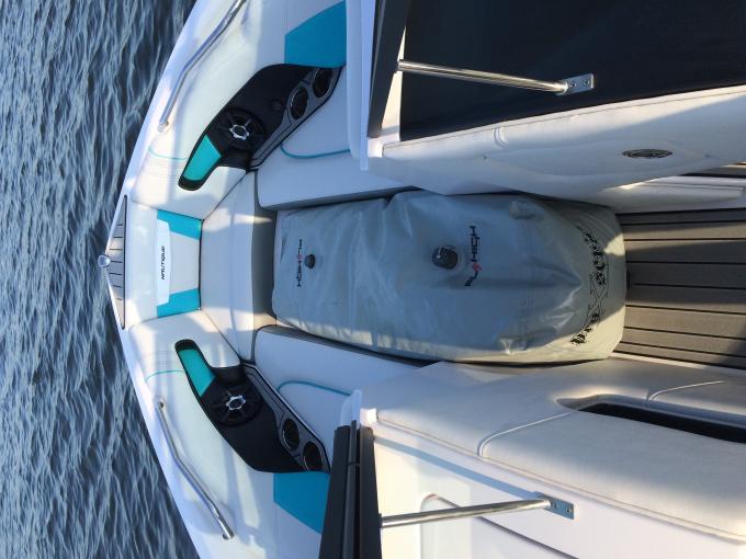

Ive been tinkering with ours by adding a little weight to surf side and I'm not getting much change in the wave. While the factory settings w pro ballast are good I'd like to see what else you all have done. So far I've added about 500 lbs to surf side via bags under seat and larger locker bags. When we do this the wave gets pretty steep so I've bumped up the speed to lengthen it a bit. We're up to 11.2 mph and 5 on NSS with the added weight and noticed something today with just the wife and I out surfing. I stood up from the helm to pull the rope in and the wave cleaned up and got longer. We surf goofy side so I was pulling weight from the surf side. I'm thinking about adding more weight to the other side and letting the NSS do its thing.
