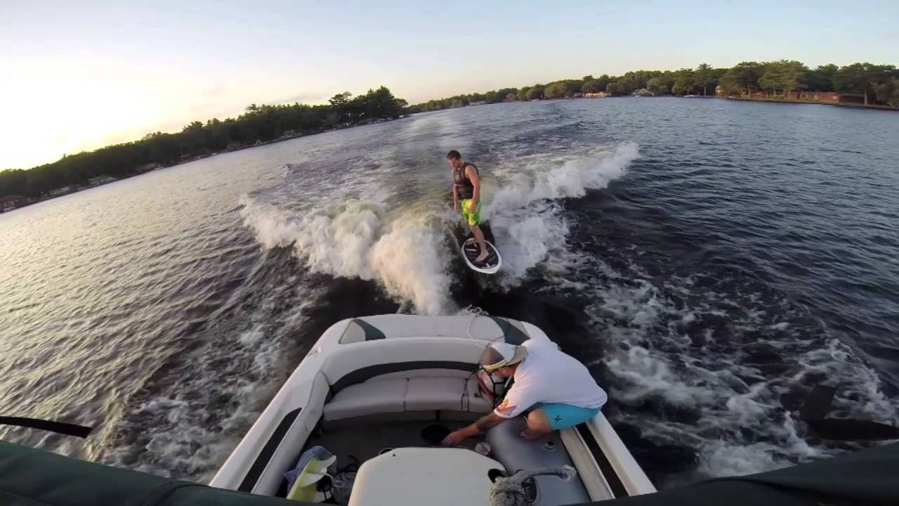

I have a similar boat (99 Sport) and been wanting to try surfing, too. How does the 1100 fill in the rear? I have two bags in the locker, but it would be nice to just have one. I know these hulls are not ideal, but I did find a surf video. It looks like they have a 600 on the surf side with another pop bag on the seat, plus a person on the side. Wave doesn't look bad. Maybe a little on the short side. Try adding some weight like that to the surf side?

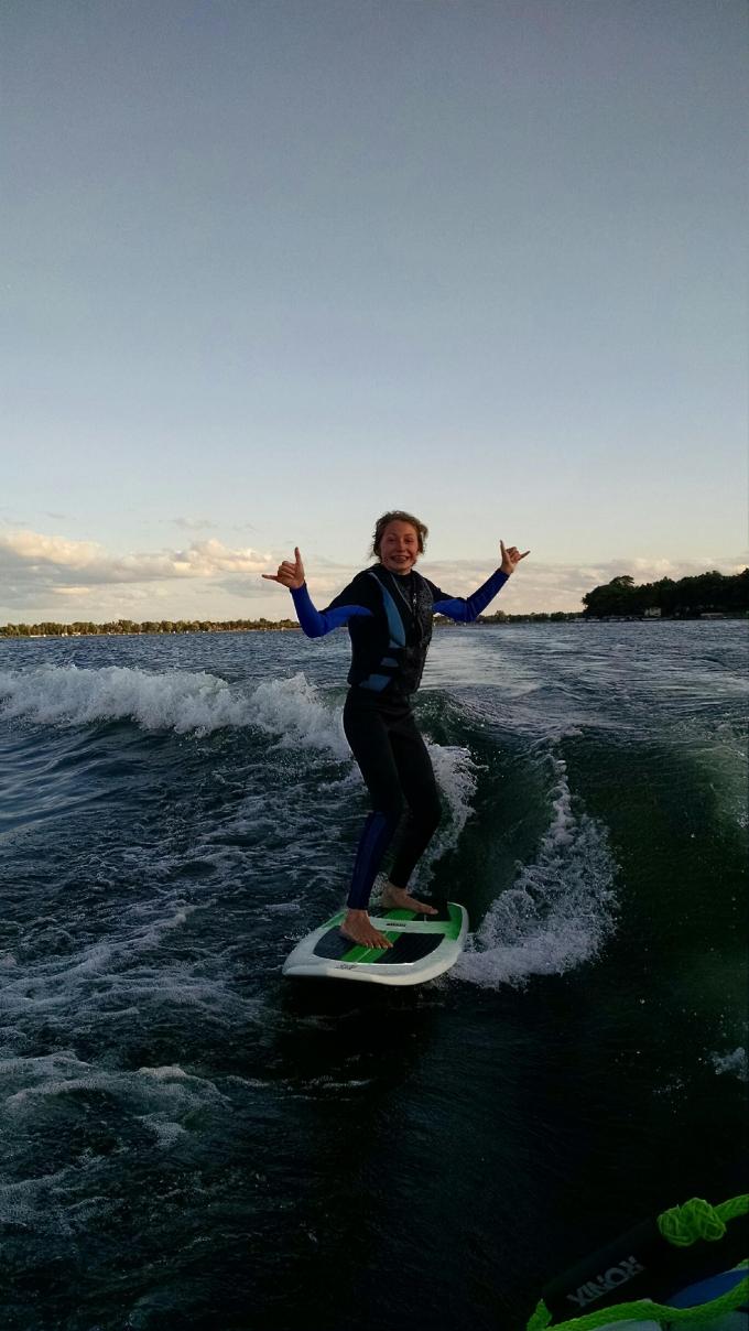

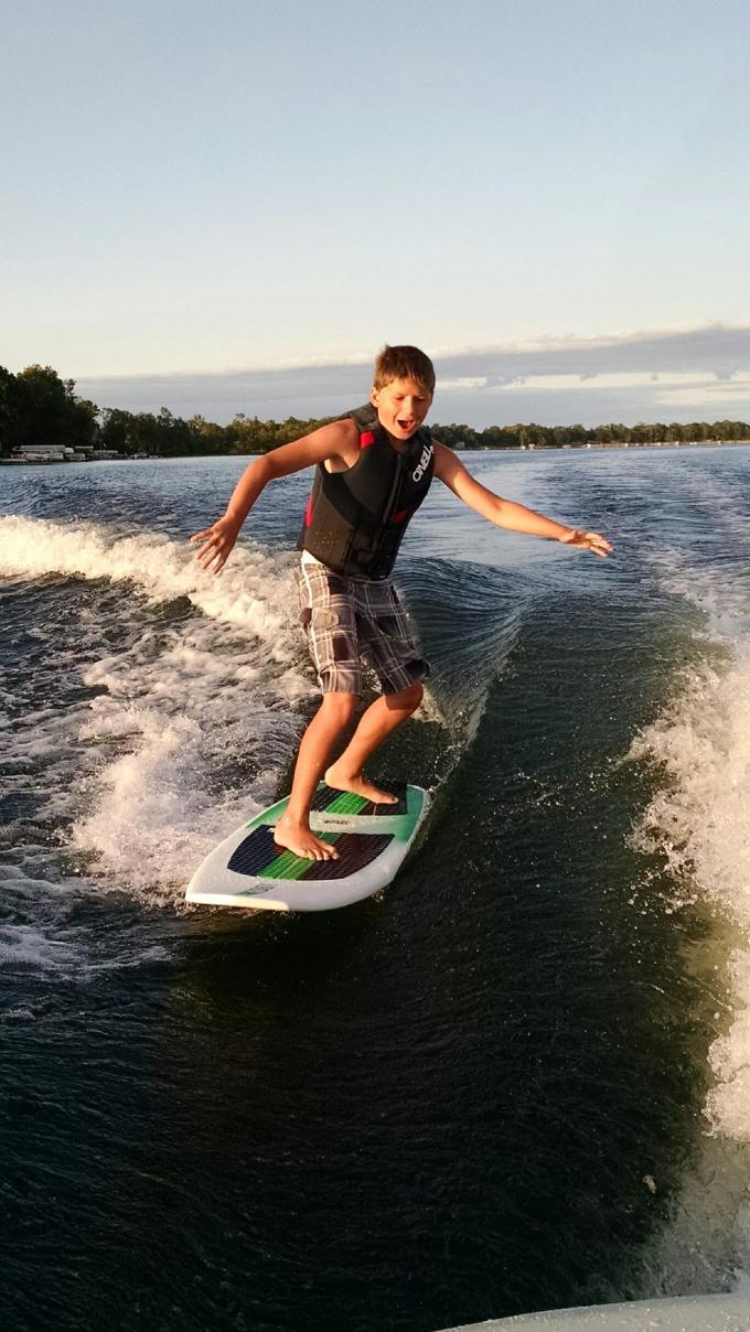

I am using a ronix koal power tail 4'11". I can try to get pictures of me, but here are my kids. Both are about 5'3" or so for reference... I have been doing 1000# in rear, 600 in the ski locker. 150# driver and 300#+ in passenger all on starboard side. 10 mph.2 Photos
I have a 97sport . Your weight seems about right but looking at your wave, it doesn't look very tall. The starboard side will surf better because of your prop rotation. I would say you either need more weight in the back, or you need to get more of the weight in the back shifted to the starboard side.
I put a 400 lb sack on the back seat in the corner I am surfing on and then about 3-4 300 pound sacks plus people on the side I am surfing on as far back as I can get. You might experiment with less weight in the ski locker. I run about 300lbs in mine but don't notice a lot of difference whether its there or not. With your hull, the more weight in the back corner the better. Weight up front will lengthen out the wave which will give you a longer surf pocket but you give up height which gives you more push. From your pictures you have plenty of length but not enough height. I weigh 210. I don't think you are too heavy.2006 SV 211 (Sold)
