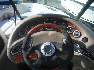

    Also since boat does not have the digital gauges, Where is the hour meter on this boat???

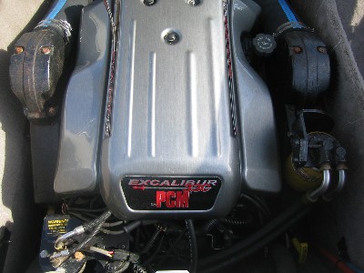

      The ballast tank issue is two fold. One is the valves that were used to isolate the tanks leak, so if you filled it to "half-way" and then shut the valve, as you drive the boat the pressure of the water can overcome the valves ability to hold water, so the tanks would continue to fill. Another is that the aerator pumps used to fill and empty the ballast tanks are not of the greatest design for that purpose. Nautique eventually switched to one reversible pump with an impeller to fill and drain the tank via the same connection. To fix this, you can add brass WOG valves (water, oil, gas) that you can get at almost any hardware store, but you lose the ability to control them from the helm. The re-plumb the pumps can be expensive since the reversible pumps are around $200+/- each.
      The rust on the exhaust manifolds is really a minor issue. The boat is 10 years old and the manifolds and bolts are not stainless, so they will corrode slowly. The best way to look for salt usage would be to check the adjustable motor mounts and metal items lower in the bilge. If it was used in salt, those will be rusted VERY badly as they are also not stainless and not painted. If the boat sat with water in the bilge area and the engine cover not opened after the engine it warm it is super hot and very humid under the engine cover.
      The speedo not working, should not be a big deal, it looks like the boat has perfect pass which should use a paddle wheel for speed input.
      Only thing I am not sure about is the engine hours being read on a gauge. On mine, it is in one of the digital displays on the tachometer, but if it has the Excal motor, the engine hours are stored in the ECM and should be able to be pulled.

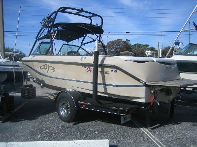

          Not the original gauges. Keep in mind (and offer accordingly) that an interior could run $3,500 - $5,000. Gel looks faded. Probably could use a good going over with some compound and then a good wax.
          Since it is a GM-based motor the dealer should be able to pull the hours off the ECU.
          From what you describe about the dealer I am not getting a lot of warm fuzzies. Either he knows the history and is feigning ignorance, or he really does know nothing about boats and probably should be peddling cell phones.
          While $20k is a great price for a 2002 SAN, it is probably reflective of the general poor overall condition. Personally I'd pass unless you want to be spending more time working on the boat than on the water.

              The gauges may have been replaced, the units of that generation were prone to failure and there is a kit available from White Lake that replaces the teleflex digital gauges with Faria gauges.
              http://www.planetnautique.com/vb5/fo...to-faria-gages
              http://www.planetnautique.com/vb5/fo...ria-conversion

                Congrats on the deal and the boat. You are smart not to finance. You'll have many fun days ahead on the water. Like Nuke said the gauges of that era were prone to fading to the point where they couldn't be read. Probably what happened here. I haven't seen too many 2000 - 2002 boats with the original LCD gauges that are still working. The kits are an easy install.

                  as pointed out above, the main thing with the gauges is to have the hours pulled off of the ecm by computer and documented. this is the only way you'll know the true hours. obviously, this may alter the perceived deal you are getting if they dont match what they say they are.

                        You would need the software interface program to plug into the ECM. For the PCM engines, it is Diacom Marine Software, made by a company called Rinda. (its the same software for many marine engine manufactures, see website) Dealer should have this available.

                          Their service department should be able to pull the hours from this engine. If they say they cant, that is a red flag. Also have them do a compression test on the motor, it is very easy to do and should be routine for their service department.
