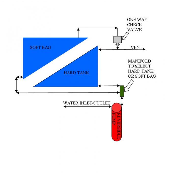

2006 SV-211... Adding a sack on top of the hard-tank for surfing.
Also added one to the ski locker - no issues there.
I've seen a few other posts about putting a small tube in the sack to prevent a vacuum from forming and preventing things from draining properly. I'm considering doing this, but I'm also considering putting the sack on a T, and then letting gravity do the work of draining it, putting no vent directly on the bag itself. I figure if I have a small issue with gravity "running out of steam", If it's draining at the back, then theoretically just plowing water with the nose high will keep it draining, OR I can just reach over and put my hand on the vent on the side of the boat and force it to squeeze the sack a bit.
Thanks!
