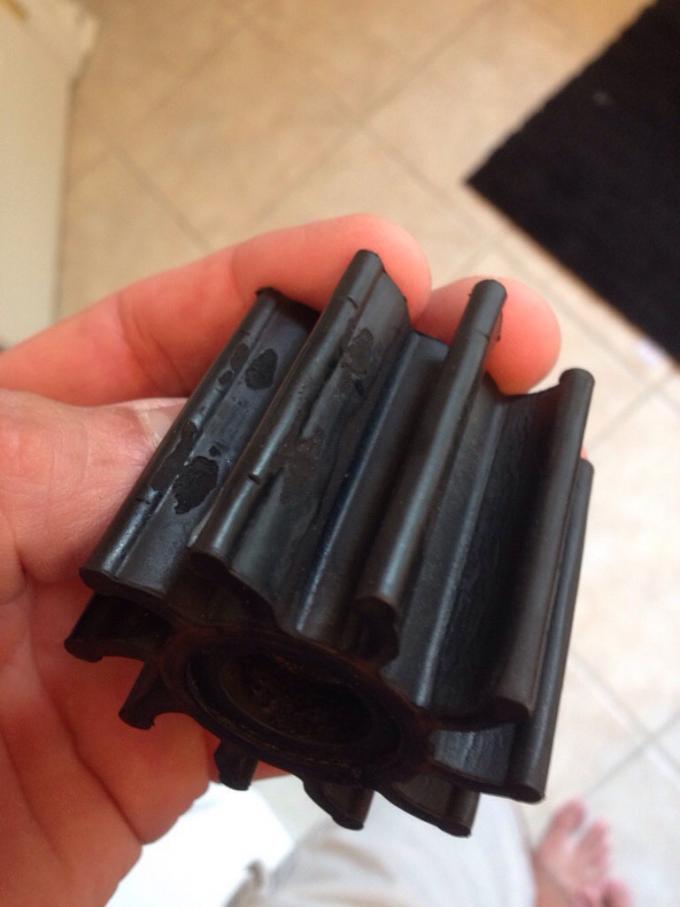

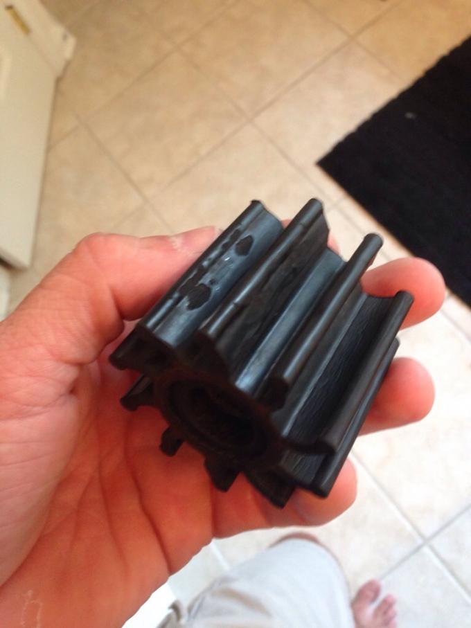

Is how your impeller starts to deteriorate and break apart.
Just under 2yrs, 190hrs, 2 winterizations.

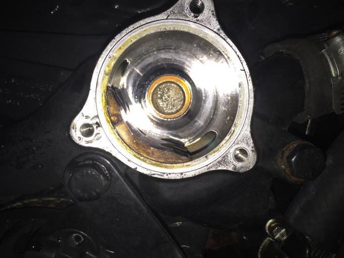

Noticed I was running approx 2-3degs higher than normal while at idle after a run. 169-172 is my normal. I was seeing 175 at idle. At speed it'd drop back down 154-162.
Swapped out the impeller... Double blisters on every rib... So it wasn't getting the full length squeegee effect on each rib inside the pump. If you see your idle temps creep up... This is where it starts.
