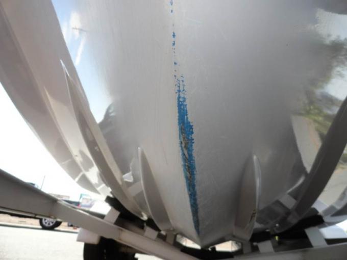

              The previous owner of my boat obviously beached it a lot and the results are as you see here. While it was easily fixed (and it did not deter me from purchasing) there will eventually be some gel coat damage if you beach it.

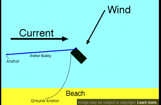

                            one more question. Since I am on a river. Should I throw the anchor behind me or upstream such as in the picture?
