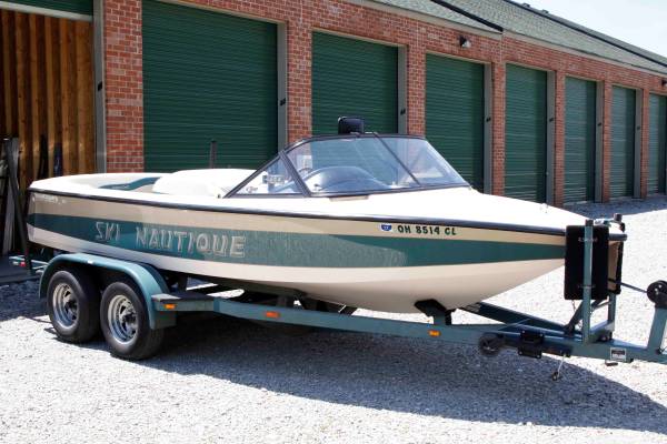

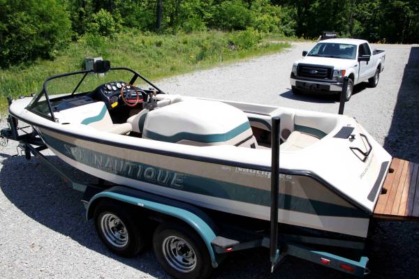

                  Went with the 1995 after test driving the 94. I really enjoy the GT40 engine over the ProBoss. And the 95 was just so clean. I am very happy with my new boat. Thanks you guys for helping me with my choice.

                    wow that thing is a beauty, congrats!

                      Great looking boat and you can never go wrong with a GT40. I think you made a good choice.
