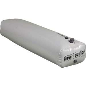

          I have a 1999 Pro Air (same front interior config as yours) and the bag the fits in the in-floor ski locker is this. Downside - it is only 370#:
          http://www.wakemakers.com/fly-high-tube-sac.html
          No way could you get an 1100# bag in the in-floor ski locker. It's just too big.

            The Rear Seat Sac (W705) fits perfectly in that center locker and weights 580 (http://www.wakemakers.com/fly-high-rear-seat-sac.html). As others have said, no way an 1100 fits in there. You can probably get a little more than the 580 in there if you go with a custom sac but most don't think it's worth the cost for the minimal extra weight.
