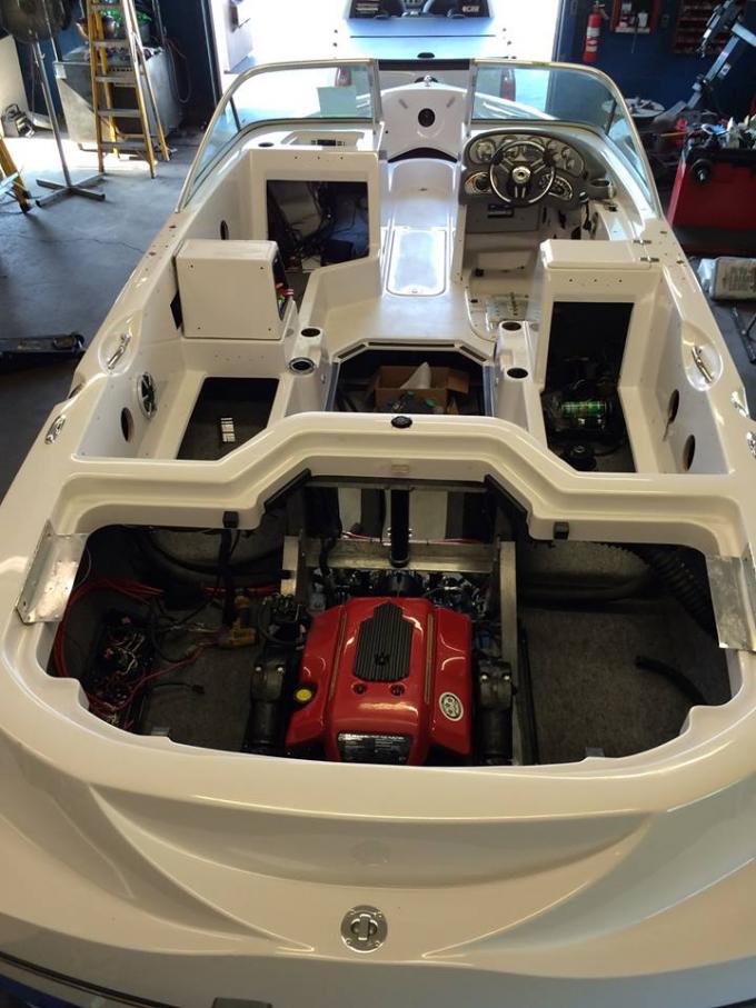

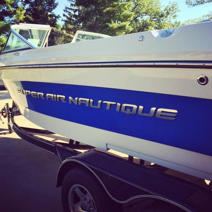

Should finish it up very soon. Needed: new motor; refreshed trans and v-drive; new steering cables; new "peach-fuzz;" new seat shocks/compartment rings; new prop shaft; new stereo; new pumps/water lines; middle windshield - basically one of everything. The tower (and roswell speakers painted to match) were just an added bonus. Tower is now removed/being finished for paint (I'm fixing all the weld imperfections before spraying it). Have the new chromax decals for the side as well.
Looks great!Please do not PM me directly asking for advice on how to repair your boat. While I would love to help everyone, I simply do not have time to respond to all of the inquiries. Please post your questions on the forum, so that all of our members have a chance to answer.

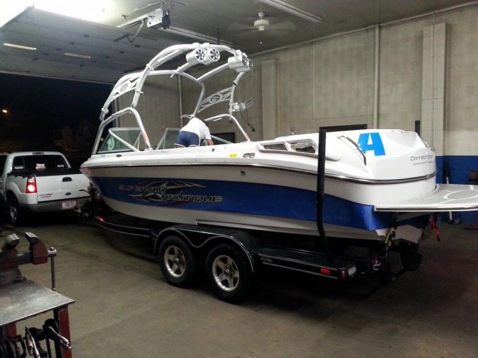

Well, buying our new house/selling our old one, plus Child #3 being born has stalled my project. I have a deadline of 10/14 (going to Cumberland for a kid's Halloween event) so I'm back in boat mode. Installed the strut/trans/v-drive and new motor this weekend. Last week wired all the new led cupholders and Seablaze X lights out the back. Tower is at the paint booth now (they already painted the black half of my Roswell horn monos blue to match the boat).

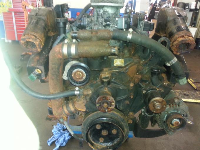

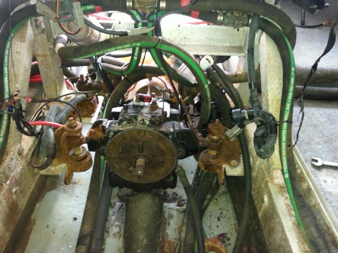

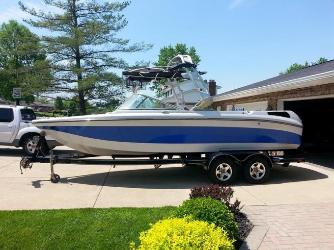

Here are a few. The photo of the actual boat is when it was pulled in the shop during a thunderstorm - so you cannot see the faded gelcoat. I spent many, many hours (and then some) fixing the gouges and wet sanding. I've repaired/painted quite a few cars - so wet sanding on gelcoat was relatively easy (except for the shear size). See the corrosion on the motor/trans. The mounts were rusted through. There is literally not one thing we have not replaced or completely rebuilt. It's a great project - at the end I will have a brand new boat for a very reasonable price, and I have the peace of mind knowing every bolt on the boat, and knowing it's put together right.6 Photos
