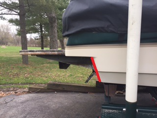

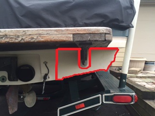

    First post for me on this forum. I am a Malibu owner (plz don't kill me...). I have an older DD that I use for skiing and sometimes wakeboarding. I would like to use it for some surfing for the kids. I can get a reasonable surf wave with tons of ballast but I don't like that much weight or listing my boat that far. I have teenagers and there is no way I want them driving with that kind of setup...so I'm looking into delayed convergence. I tried a surfgate system last year, but since my 'bu has a stepped hull it just sent out tons of spray. This spring I want to try an NSS setup. I searched the site and have gotten lots of ideas, but I have a couple of questions that I hope you can help answer.
    1) My stepped hull angles down toward the bow instead of vertical. Will I need to put in spacers so that the NSS plate is vertical or will it be ok to have it at that angle (see pics). My thought is that if I have the NSS plate at that angle it will just divert spray upward.
    2) I wonder if I would get a better wave if I had more plate out the bottom. There are 2-pictures of what area the plate could cover. Any suggestions? I will most likely start out manual gate and having a larger plate will definitely be a more difficult setup to move back/forth.
    3) I plan to build a 3-plate system. The outer plates will be stable and secured to the swim platform (at least until I get it dialed in). I have read that you need to do 30mm down x 40mm to the side. Is this the general consensus?

    I would think that if you had more plate come out the bottom then you may as well just use a wake plate. I think coming out the side causes your boat to drift side ways a bit. That is my thoughts

      It is my understanding that is how NSS works, it makes the boat crab a bit to the surf side forcing more of the surf side hull in the water.
