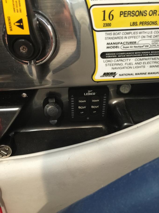

    To control the NSS plates I am using the Lenco Double Ram switch pretty much connects right in to the NSS harness.
    Each Ram has 2 wires which expand and retract each ram.
    * 12 volts to one wire expands it.
    * 12 volts to the other wire retracts it.
    The harness also has a 12 volt, Neg and a Exciter wire.
    http://http://www.lencomarine.com/in...witch-kit-dual
    I have a blue LED right on the dash when the system is powered it lights up so I know the unit is hot.
    One really nice thing if you have the Lync 2.0 system it will automatically retract if you go over 15 mph.
    My Lenco controller is right under the throttle fits perfect and it's hidden.

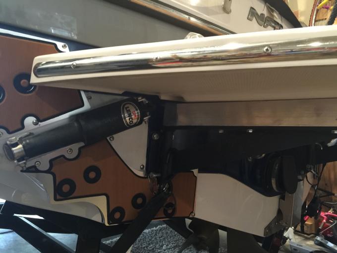

        Couple of pictures so you can see how its installed.
        Placement of Lenco Ram Switch.
        There is a shot of the dash as well when the RAM is deployed it lights up a blue led light between the fuel and speedo.
        I rasied the platform as well to clear the ram as well as move the platform out of the way.

          Which model Lenco Rams did you use? I have a couple with 4.25 inches of throw IIRC, which is what the Malibu Power wedge uses. I suspect these are the same. If anyone wants them, let me know. I bought them for the power wedge replacement, but never installed them.

                        Is your control only on/off or can you dial it in from 1-5 for different levels of steepness/push, like how the NSS works on the 2012 and ups? I'd assume so if it is all the same parts but just looking to clarify

                          Yes you can adjust in the plates in 5 or 6 different settings via the Lenovo switch. Works really well going out this weekend first time out this season. 😀

                              do the Lenco "rocker/switches" work in "steps?" Ie. you push it one time and the actuators move a little bit (set distance), push it again, and it "steps" again the same distance? If so, that is pretty cool! Oh, and I really like your idea about raising the platform, I may do that as well. Did you use a long screw through the 2x2 tube, or nuts and bolts to the original bracket, then screws through the top of the tube into the platform itself?
