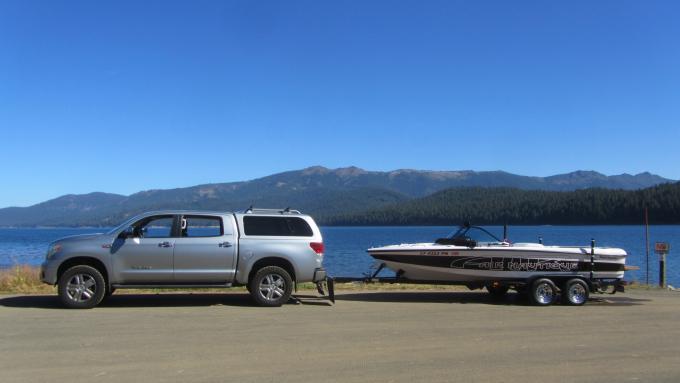

                      Just some more thoughts. Great topic and ideas. If you don't know much about tires and are running P- (passenger rated) Tires. you need to do some research.
                      If you have not driven a 2017 diesel 3/4 ton truck, you will be very surprised. They are very quiet, very powerful and fast, and they don't smell. If you need an SUV type vehicle purchase a quad cab short bed and add a camper shell Leer or Snug Top and any of a number of custom bed kits.
                      I am going to throw another issue in here that has not been discussed fully. Trailer sway and causes, you need to watch this video and gain some information on causes and solutions. I do not think the P3 will work on the boat trailers, but knowledge helps. https://www.propridehitch.com/propri...control-hitch/
                      I have this hitch on my Airstream, approximately 8600 lbs. loaded. I think of it as insurance as it is expensive. RV trailers have electric brakes an huge difference from surge brakes. It amazes me that boat dealers are selling trailers that barely meet the weight requirement for the boats they are selling.
                      Sway bars, air bags, and Light Truck (LT) tires can make the world of difference in a tow vehicle but it will not change the tow rating.
                      PS. Jeff you need to air bag that Excursion. https://www.airliftcompany.com/
                      The Tundra has very soft rear suspension but the remote control Air-Lift system with on board air compressor allows you to change on the fly ride height and quality.

                        #116
                        I have wanted to do that for years. I agree that it would be a great idea. Maybe I'll check into that next week.

                                #120
                                Possibly a site sponsor? There are a few companies that make the air bag set ups. Air-Lift seems to have a design that mounts wider (toward the wheels) than others companies. This width adds another level of stability that the companies with the narrower mounting designs can't quite achieve and the remote systems are the only way to go.
