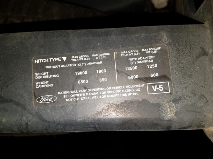

            #95
            Originally posted by NautiqueJeff View Post
            3. This 11,000 lbs. capacity is only valid when using a weight-distributing hitch.
            4. Like many tow vehicles, the towing capacity of the 2005 Excursion without use of a weight distributing hitch is limited to 5,000 lbs.[/INDENT]I feel confident that the trailer itself, the axles, and the tires are within spec for the weight of my G23 as I normally load it (including the lead). The limiting factor appears to be the axles, at 9,090 lbs. capacity.
            I am sorry to resurrect this thread, but it is always a good discussion on safe towing. I read in detail the 2015 ford document that you quoted here, since that is my year of truck. There is a little blurb on page 28 of the document for 2015 that states that the F150 towing capacity is also 5,000 pounds, and diesel truck F250 is 6,000 pounds. Then if you add a WDH you get 14,000 pounds with a diesel truck, and 12,200 with F150. It is really placed in an obscure location and that is after pages and pages of specs that state the higher towing capacities, and no mention whatsoever of the weight distribution hitch. I find it very misleading on Ford's part.
            I repeat that several previous pages of towing specs do not mention the WDH clearly.
            So I went and took a closer look at my hitch, and boom, there it is. Shame on Ford for publishing pages and pages of charts that state ratings that are super high, and then installing a hitch that is the weak link.

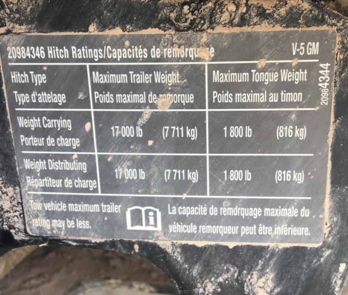

                                #105
                                Go look at the sticker on your hitch, it is still going to have less of a weight limit than your boat is. IIRC the dually was only 500 or 1000 pounds more. The DRW increases the capacity with a fifth wheel or the WDH, but not so much without. The weight limit is the hitch, not the truck. It burns me more than a little that Ford advertises 12,500 tow rating, but forgets to tell me that you need a WDH to be over 5K. I even have a 19,000 pound trailer tow rating if I use the 2.5 inch receiver. That is more than a Chevy, IIRC.
                                It wouldn't surprise me if the Duramax is the same way. Someone with a Chevy go take a picture of the sticker on your stock hitch, if there is one.
                                Nope, I'm good up to 17,000 for weight carrying and WDH. Sorry about your Ford....
