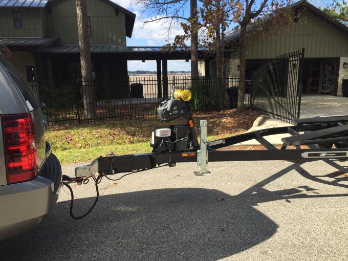

                  #83
                  My electronics are mounted in a battery box near the tongue.
                  • c640947
                    • Jul 2013
                    • 112
                    • Badin Lake, NC
                    • 2021 Nautique G23 Paragon ///// 2016 Mastercraft ProStar with tower
                    #84
                    Very clean. Can I ask some follow up questions?
                    1. Is that aftermarket or did the manufacturer put that on the trailer before delivery?
                    2. If aftermarket, can you share what parts were used? By the pictures of parts I had seen I am surprised they all fit in a battery box.
                    3. I would love to see detailed pics of how the battery box is attached and how the hoses are run.
                    4. did you consider putting the box on a pedestal or do you feel that the likelihood of water getting over the edge of the box is a non issue (I assume the box is water tight.)
                    5. Would love to see pics of the weight distribution hitch hooked up if you have them.
                    Thanks in advance for any additional help. I am taking mine to a trailer company tomorrow to have them do the work so any direction I can provide them is good.
                    Andrew

                      #85
                      So mine didn't end up as pretty as Jeff's but still works amazingly well. Key is I believe it will tow very safe. All of the new electricals should be plenty high enough so as not to get wet even if I have to back quite a ways down. Here are some pictures:
