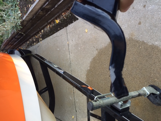

This year I bought a 08 230. Heaviest boat to date. I also started towing a lot farther than before. Instead of 20 min to the water with the annual long distance tow, I now go 2 hours each way to get good water. The boat is 4300lbs, trailer is 1300lbs, gas etc I figure I'm close to 6k if not a little over.
I have a load leveler to tow my camper that is rated at 14,000lbs. So I'd been considering using it, but really wanted to avoid if possible. My truck is rated at 9000lbs so I'm OK there. But my ball mount is 6000 (I really didn't know but knew it was class 3/4). I've made the tow 5-6 times this season without issue. On the way back last Sunday I noticed more sway and vibration than I'd had in the past. I stopped to check.
The experience reminded me of this thread, you are only as safe as your weakest part.2 Photos19 SANTE 210

6000 pounds is a probably the bare minimum... I always take into account the force with braking and panic actions... That could be much higher than 6000 pounds... Not to mention the condition of some roads.... Your photos are an excellent reason to always go 'over' in terms of capacity carrying...
