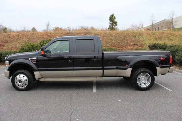

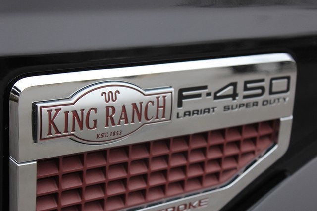

Even that wouldn't legally tow my G23 with the gear I keep in it without weight distribution. The F-450 is limited to 8,500 lbs. without weight distribution.
See page 25 of the Ford Towing Guide.Please do not PM me directly asking for advice on how to repair your boat. While I would love to help everyone, I simply do not have time to respond to all of the inquiries. Please post your questions on the forum, so that all of our members have a chance to answer.
I've been using a weight distributing hitch for a few years now on my Grand Cherokee towing a 220... a bit of a pain to use (mostly handling/moving it from the garage) but I believe my setup is completely legal now and it actually drives ok. The surge braking is slightly affected, but works when neededOriginally posted by NautiqueJeff View PostI can honestly say that except for my old 210, I have never in my life seen a weight distribution setup used on a boat trailer. And I have seen a ton of these boats being towed.
Agreed - without WD. With WD your capacity moves up to 18,500lbs.Originally posted by NautiqueJeff View PostEven that wouldn't legally tow my G23 with the gear I keep in it without weight distribution. The F-450 is limited to 8,500 lbs. without weight distribution.
Not sure how many folks run with 1000lbs of lead in their G. Pull that out and you're legal. You could even step down to a DRW F350 w/ 6.7L and tow up to 8500lbs without WD.
Great post and very informative. Thanks for putting this together. Makes me scratch my head when I see a G23 pulled by a Toyota Tundra.Last edited by a0128; 03-06-2015, 07:40 PM.
Yep, you're absolutely correct. I am sure I am in the minority towing around that much lead. I should probably switch it to water ballast, but I hate to give up the storage space.
That's a great truck you've got there! One of these years, if my Excursion ever decides to die, I'll probably end up getting a dually. I bought the Excursion new in 2005 and it is pushing 235,000 miles now (many towing boats), and it is still going strong.Please do not PM me directly asking for advice on how to repair your boat. While I would love to help everyone, I simply do not have time to respond to all of the inquiries. Please post your questions on the forum, so that all of our members have a chance to answer.
An F450 only rated for 8500 on a conventional hitch - very surprising. I'm guessing that means it's a gasser? A new Silverado 1500 with a 5.3L is rated for 9,100 with 3.42 gears and 10,800 with the Max Tow Package (3.73 gears), with a conventional hitch. A 6.2L is rated for 11,900 with the Max Tow Package on a conventional hitch. I had one with the Max Tow Package, and didn't feel all that comfortable from a control/breaking perspective (it had plenty of power), so I moved into 2500 Duramax. The difference is night and day. With a conventional hitch it's rated for 13,000.Originally posted by NautiqueJeff View PostEven that wouldn't legally tow my G23 with the gear I keep in it without weight distribution. The F-450 is limited to 8,500 lbs. without weight distribution.

I think the 8,500 lbs towing number us for the bumper type hitch. That truck is rated for a lot more than that using a frame mounted hitch and way more than that with a fifthwheel hitch. Don't think I've ever seen a F450 towing with the bumper type ball.Originally posted by ironj32 View Post
