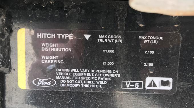

    Originally posted by Longhorn1186 View Post
    I did not like the limits on my older F250. Our new 17 F350 has zero issues. Ford got their towing numbers up finally. Click image for larger version
Name:	Screen Shot 2017-04-12 at 3.21.59 PM.png
    Thats what the hitch is rated for.... not the truck right?

              @nyryan2001 That is the conventional rating for the truck with that installed hitch. You will have a few other restrictions like what insert hitch you decide to use, the truck rating and tongue weight. In this case, the 2017 F350 limit was 18K, the weight safe hitch I had a 10K pound limit (2 inch insert using the reduction sleeves from 3in to 2in). So, while the hitch part on the truck says 21K pounds, its a little misleading to someone who does not know anything about towing (NOT saying that towards you). Easy to just say OK and load it up to unsafe levels. I have since upgraded my truck (for other towing I do) to a F350 King Ranch Dually with 4.10 ratio. I upgraded my weight safe hitch to the 3 inch insert with a rating of 21K pounds instead of 10K pounds on the 2in insert hitch to match the truck hitch of 21K pounds so there are no weak links in the towing. Before I was limited to 10K pounds (buy the 2 inch insert hitch) although the truck said 21K. We tow a horse trailer as well as a few other things that require a gooseneck or 5th wheel. Been a long day and tired, hope this answered your question. Here is a photo of our current tow setup. A little overkill for the G23...but works for our other needs. Click image for larger version  Name:	IMG_0515.JPG-1.jpeg Views:	1 Size:	56.1 KB ID:	533567
