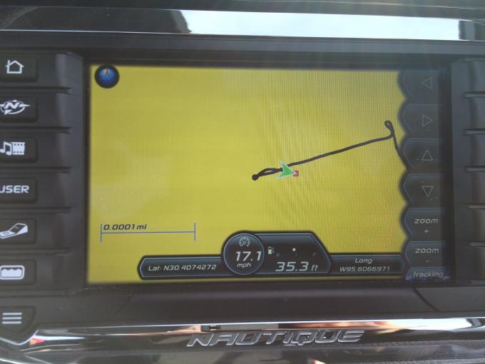

    I picked up my new G23 a few weeks ago. When I pull up the nav, no lakes come up - as if it doesn't have a database installed. I asked the dealer and they say it's another $500 to $600 to get a data base. It's not standard as Nautique doesn't know where the boats are going, so it would be a waste for them to install a random database.
    I would have though a database would come with a new high end boat. Anyone have experience with this?

                This is exactly why I wanted to have the nav system. We will visit a few lakes this summer, and even though the iPhone works great for tracing your path back, dash mounted is easier to use and see.
                Right now, the outline of the US shows up, and all the tracks I have made. But no land / water notations.

                  I just ordered a G21. List shows: LINC Map Card: US under details. Are you zoomed in too close on that picture to show the shore?

                    If I zoom out I see the exact same.. no water.. and I am clearly on the lake..
                    I just checked my options sheet - "LINC Map Card US" Good thinking. They can't dispute that....

                            Can you zoom out and see other lakes? Nautique uses Navionics cards and unfortunately not every lake is mapped.

                              I test drove a 2015 G23, on the lake I primarily use and it was on the map. It's a larger lake, takes about 25 minutes to get across at normal speeds.
                              The G23 that I bought was still in the factory shrink wrap, so the boat I previewed was their "demo"
