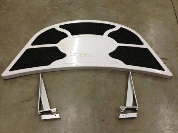

    Will this swim platform fit my 1998 Air Nautique? Thanks in advance.

    Any idea what it came off of?? If not get a straight edge measurement end to end at the hull side and then a few points along the arc back to the straight edge at hull side. Verify on your boat using a straight edge to the hull.

      The seller thinks it might be off a 2006 216

        It may work with some modifications to the platform brackets. He issue you will have with the Fiberglass is that the fiberglass platform only has certain mounting points that can't be moved. Teak platforms can almost always be adjusted to fit any model Fiberglas ones CAN NOT. I would have the seller flip over the platform and give you the measurements of where the mounting points are and compare them to yours

          The brackets on my 99' ski and 99 sport were different, not saying you couldn't make the pictured ones work, but it will require changing out either the bracket receiver on the transom or the support bracket or the platform. I wish my 2005 ski had the pictured brackets, they are much easier if you have to remove your platform for storage as I do.
